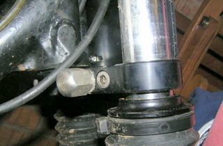

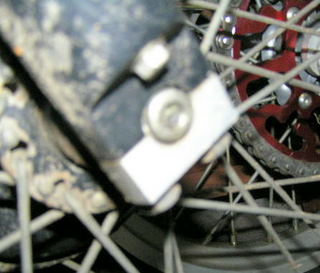

some quick snaps from the garage this evening please bear in mind that bike is used at least 40 times a year and was in use yesterday so it needs cleaning and some maintenace but the fotos should give you an idea (clearly i cant ride or take photos but hope they are of some use)
Attached Image: P1021917.JPG
Attached Image: P1021926.JPG
Attached Image: P1021928.JPG
Attached Image: P1021923.JPG
ps the rust is the water that i washed the bike with at the trial. as i had to wait for my missus to pick me up i shelteredv in the bucket of an ackerman from the hail and sleet. to make the bucket 'habitable' i used an old bucket to scoop out the 100 litres or so of rainwater that had accunulated and rusted in the digger bucket (probably, definately the first wash since october fro the bike)
