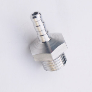

The idea with the vents seams to be logicaly, I didn't think about this. But is it possible that there are no holes in my filler caps? Both are made of grey plastic and they seam to be stock...
Maybe I should drill a small hole in each of them and put a little tube in it.

If the primary vent is allways in the cap, this could be the source of the problem because there was no hole in the cap. I drilled a hole in it and put a little tube in it which ends behind the engine near the swingarm.
