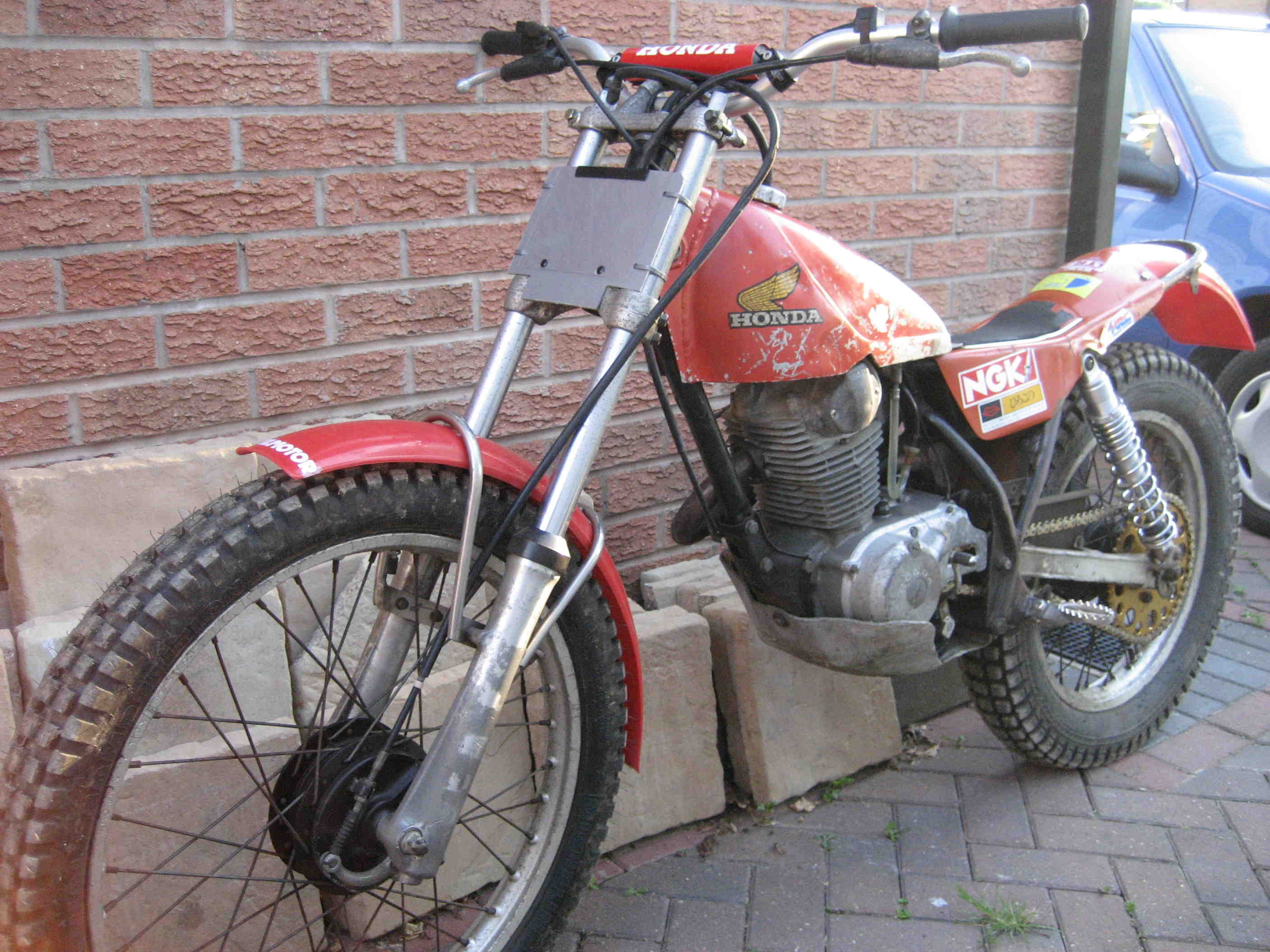

That bike looks familiar! I spent many hours looking at a picture of it on a website where it was for sale, trying to think of a way of raising the money!
Bought this instead: Attached Image: IMG_1067.JPG
