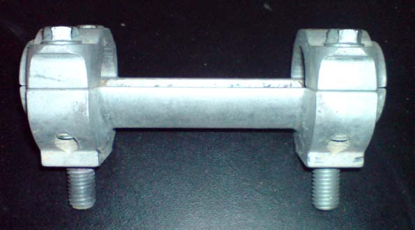

Offing up the 08 KTM clamps to my Fantic yokes its defo possibility. I did measure the fat bars (handlebar diameter) on my KTM and they came in a 391mm round. My scorpa sy, which has trials fat bars also came in at 391mm round. The original fantic mounts would have to be removed (machined flush) and then two holes drilled throw to yoke to mount the KTM clamps. I would consider fitting the clamps myself but i don't have the tools to machine the top yoke. I've taken a photo of KTM clamps which maybe of use.....let me know if you go for it.

That looks like a good mod. :thumbup:
