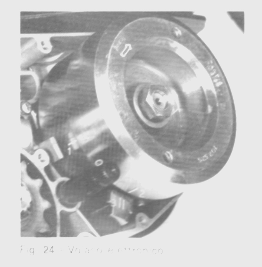

Ok ... here goes ... The timing spec is 1.6mm before tdc on the piston corresponding to 17'degrees on the flywheel ...
Or pull the timing cover and you'll see a index boss above the K.S. shaft , between a bolt hole and the flywheel. Below that you'll see the pickup with two lines on it . Now rotate the flywheel clockwise and on the edge of the flywheel will be 2 scribed lines , line up the 1st one (A) with the case boss mark and the second line should be between the two marks on the trigger body . Hope that makes sense , and the marks on the flywheel can be hard to find due to age and corrosion .
But Make sure your pipe is Clean inside . Very sensitive to exhaust restrictions . and chamber shape (DENTS).
Best of luck,
Glenn

I`ve just checked the timing and found it to be slightly out. When lining up point A with the crankcase boss the timing line was slightly outside the two marks on the pick up. Its now dead centre and the bike ticks over perfectly and picks up on the revs much cleaner. Looking forward to the weekend to give it a try.
