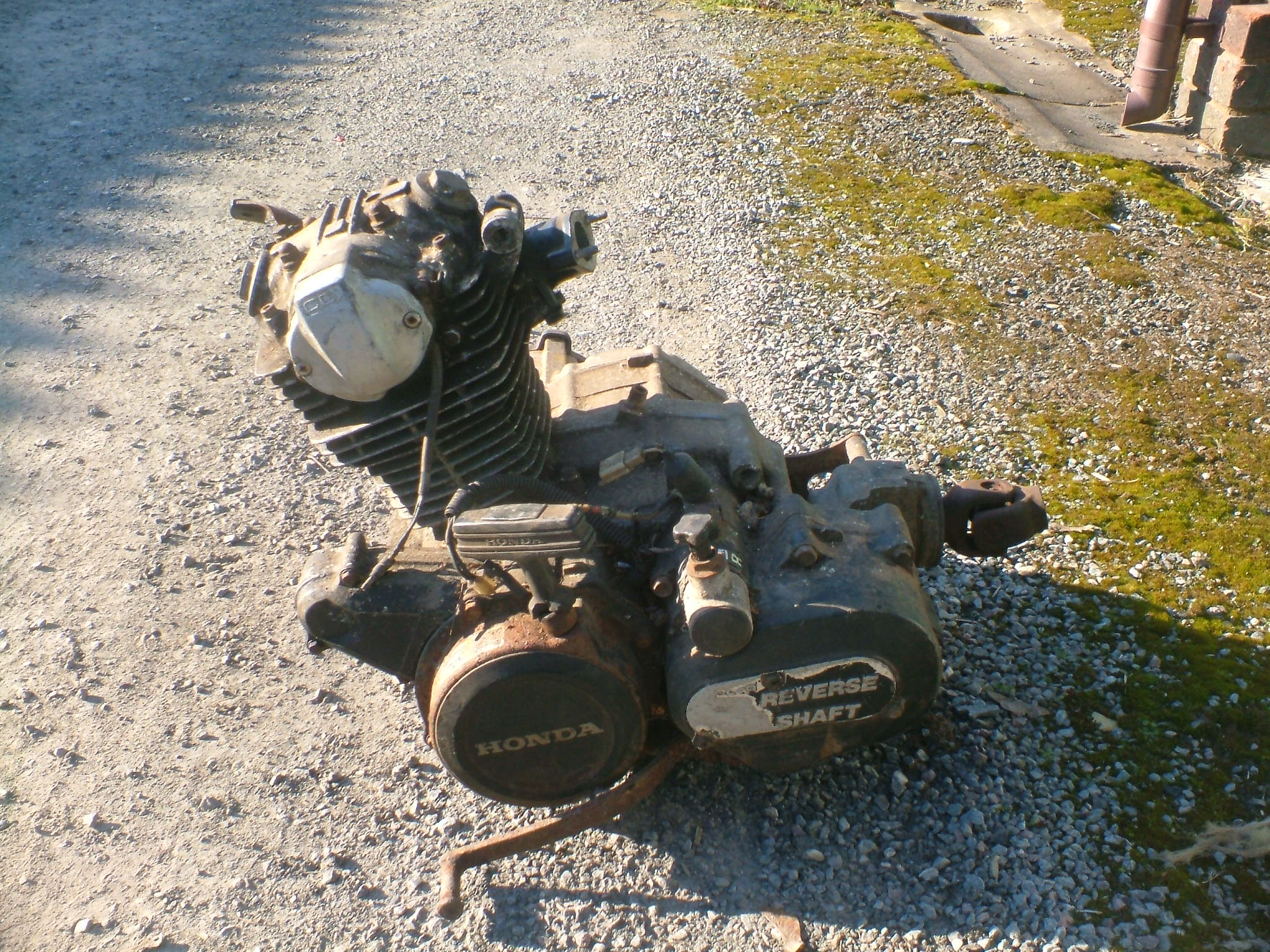

Is this one or do you know what the difference is ?? Thanks

I've got a barrel off of an ACT 200X and the fins are indeed larger, haven't got round to fitting it yet. It needs a re-bore and I was considering using 67mm piston.
Bo
dont think the one on ebay has the big barrel,
look for one with a forward kickstart !

So is that a standard 200 top end (not cam )

Hey that looks cool..... Reverse gear and shaft drive!!!!!!!!! :rolleyes:
