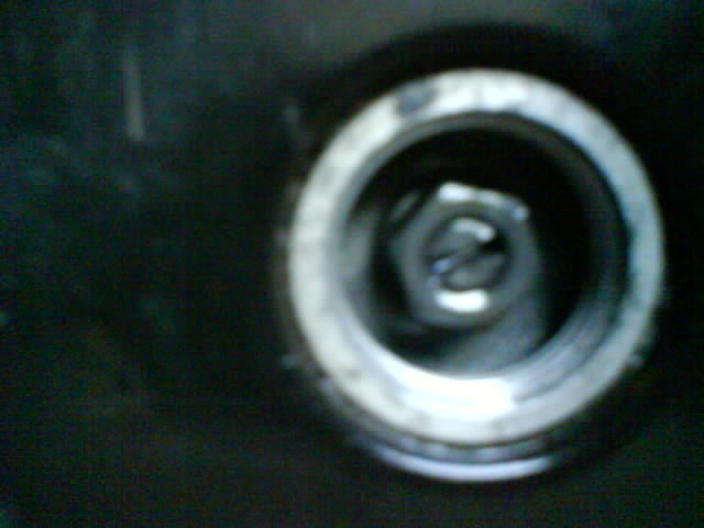

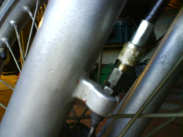

Ive just bought some new domino clutch and brake assemblies and new cables to go with them but im having a few problems...
Brake cable is too long but ive overcome this by putting in an extra adjuster as a spacer but also the clutch cable is too short. I thought to myself no problem ill just adjust the clutch as its only JUST too short but when I took the cover off the adjuster I was expecting to find an adjuster screw and a lock nut but all I found was the screw. Ive HOPEFULLY attached a couple of pics to help explain but is this set up correct or have I missed something ?

Thanks Hewson. That was very helpful.
Someone had obviously butchered mine but ive machined up a little insert to return it to pretty close to standard. Thanks also to Bill Pye for his advice. Ill certainly be using him for parts in the future.
