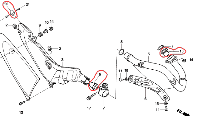

hey guys i would like to know what restrictors i can remove from a 06 monty 4rt and can any one tell me how many there is all togeather??

Hi , I removed the bush in the front pipe, the bush in the mouth of the center section and the bush at the end of the rear silencer.
I tried the bike and then re fitted the bush on the end of the rear silencer as it made no difference to power, it just made it louder.
The bike then ran sweet .... :rolleyes:

Attached Image: MONTESA_RESTRICTORS.gif
I took 2 out left the one on the end of the silencer in. Bit more noise friendly :rolleyes:
