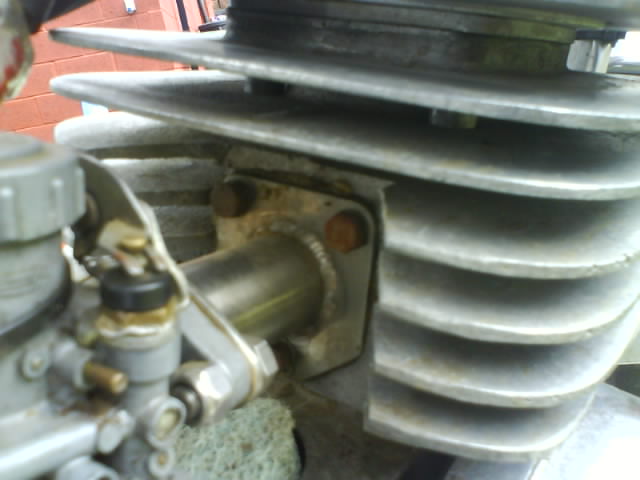

I am a new member on here. I am also a member of the Francis Barnett Owners Club and through this have now taken ownership of a converted FB trials. Its based on a 1959 FB Falcon.
What i need help with is to identify the conversion on the engine. The bottom end is a Villiers 9E but the top end I was told is a 250 conversion. I have attempted to recearch this and the nearest I can find is a Marcell conversion. Can anyone confirm this or knows more about this. Its all alloy and the inlet stub is deep into the fins with 3 screws holding it on .The exhaust is held by 2 screws The only marking is at the base of the barrel and I think it MB
My second attempt to do this as the first sems to have gone missing although it want to stop me using web site details
With luck my pictures will be visible to you .
Regards Ken

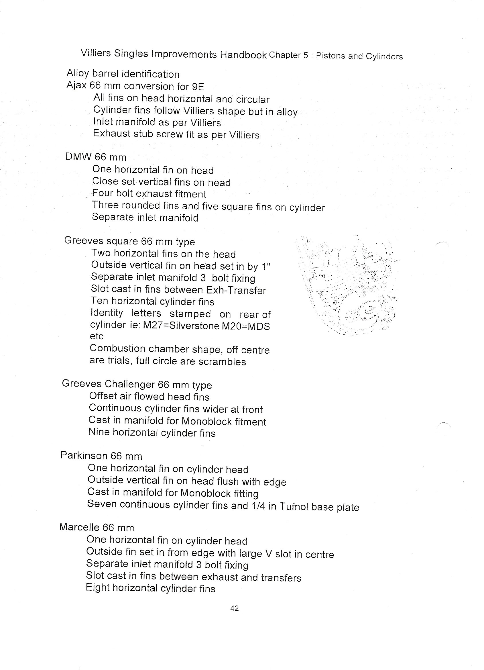

Posted 17 July 2010 - 08:43 AM
Looks like a marcelle from the bottom identification ........

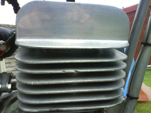

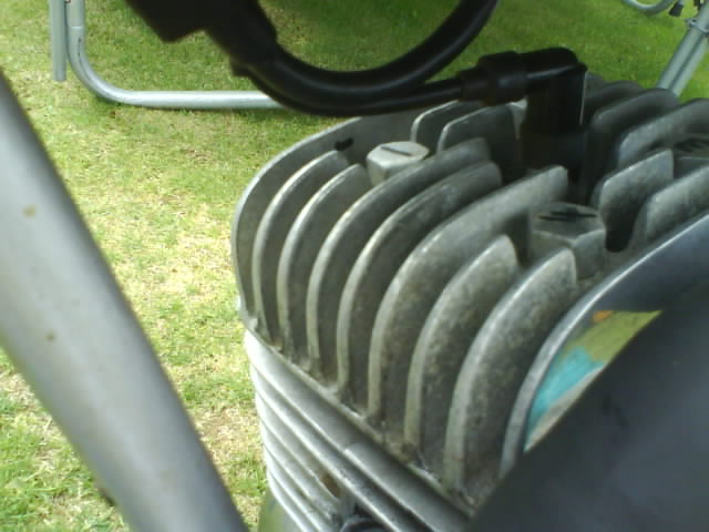

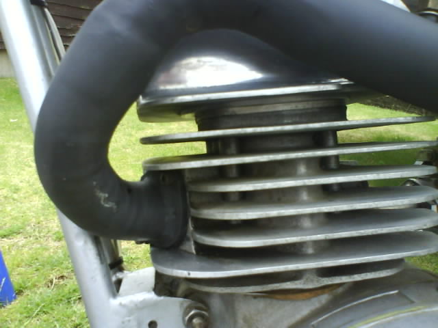

Posted 17 July 2010 - 01:04 PM
I had the same problem when i bought my sprite trials bike , the closest match i found was the Marcelle , but the marcelle as 8 horizontal fin's on the barrel , but mine only as 7 .......
