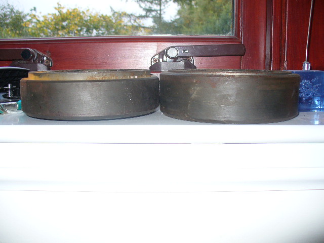

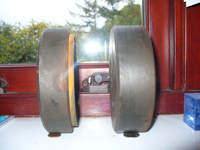

A picture is worth a thousand words !
Attached Image: flywheels 001.jpg
Attached Image: flywheels 002.jpg
Which is SWM and Aprilia, guess.

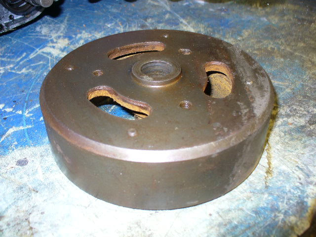

Posted 01 November 2010 - 10:39 AM
Some pics of my flywheel findings - with further mods this weekend Carb, timing and ignition "settings" :banana2: bike now revs out much better and am liking the lighter weight much more than last time I rode with it. Was too stally and weak feeling. Am still going to make one with in between weight (I like the sound of Burgat recommendation of 800g? removed in a previous post I read) Grip is affected but nothing that throttle control and body engish shouldnt sort.

Another difference flywheel wise is the Aprilia Rotax doesn't have the weight on the clutch side.
