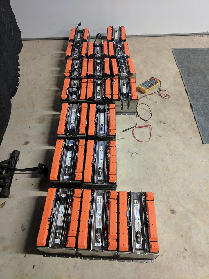

I was excited about possibility of using cells from Fiat 500 electric car battery but they are way too big :(
PS. Anyone wanna make Home Powerwall?
1 person likes this
