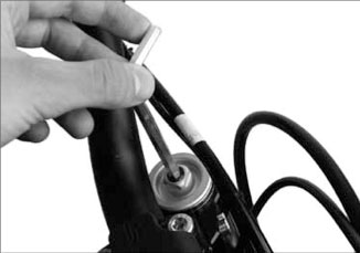

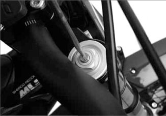

All the different year Shercos have pre-load adjustment on the rear shock, which can be adjusted using these threaded collars, on the bikes with 2 collars you have to unscrew the one furthest away from the spring first to unlock the other collar (Bikes with one collar usually have a small grub screw that locks the collar in place so make sure this is undone) then wind this collar till the desired ride height is achieved. Make sure you relock the collar after adjusting.
On the 1999 and some 2000 bike plus the 2006 onwards bikes the front suspension can have the ride height altered and the damping adjusted using the adjusters on the top of the fork legs.
Spring pre load adjustment, clockwise for increased ride height.
Damping adjuster, clockwise for increased damping i.e. slower rebound.
