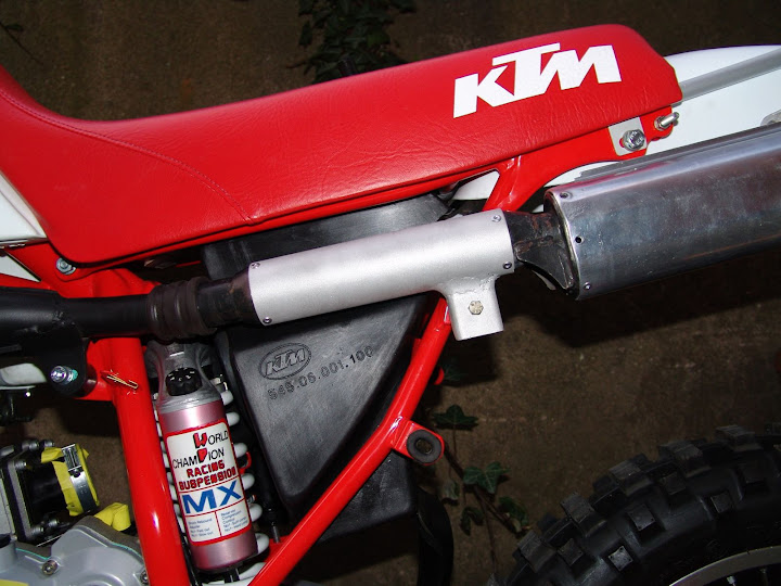

I used insulation pads for the refill as the inner holetube of the mid section has an open end and I hade concenrs that loose rock wool as insulation might be blown away just because of the open end of the hole tube, here a sketch of the inside:
For replacing the insulation you have to cut the silencer body in two pieces, with a cutting blade of a small dremel, back side (red line in the sketch). Lift of the one half and take out the inner hole tube that is probably braced to the inner wall of the exhaust manifold. Clean the inside of the exhaust body and the holetube too, using a wire brush until the holes are free again.
Wrap the pad around the holetube. As the volume of the mid section is moduled you have to reshape the pad insulation with a sharp cutter to the form of the silencer plus you have to add some slices of insulation pads where the silencer have the bulge. To keep the long slices where they belong befor inserting the "package" back in the mid section body wrap some steel wool made for exhaust around. You need thick steel wool sepecial made for exhausts from a coil, the standard wool you get frm a DNY or hardwarestore will burn away.
Then it is easier to insert the package again. Look up that there are no voids left or that you have accidently pressed the pads too much. Then brace the holetube to the inner wall of the exhaust so the tube won't start to rattle. Now you can reweld the to piece together. I personal have no skills in welding or welding tools so I went to a car body shop that do restaurations these guys do a pretty good job.
I have no experience in long terms with this set up but had made some with my enduro bike, (KTM 500), where I have to replace the exhaust insulation regulary as the bike need a lot of two stroke oil and gas clogging up the silencer very quick. I therefor have modified the mid section of the exhaust so I can replace the insulation without cutting and welding, this is a huge advantage in terms of ease of servicing.
The rock wool insulaton in my experience only worked good when there where ready made inserts for the exhaust available, sadly they don't sell them anymore. The loose stuff don't work so well as also when right filled it will get blown to the rear end of the silencer in the long run, leaving a void in the beginning and a too much compressed area at the end. What I also noticed is that the loose rock wool does not absorb the oil so well. I now use glas fiber thread knitted wool that comes in plastic bags. The producer gives you the weight per liter volume that has to be used. You then calculate the volume of your silencer subtract the volume of the inner hole tube and then you have the weight of insulation wool you need.
This stuff works only if the holetube goes through the complete silencer body so no option for the Bultaco.
You just fill up the hollow between silencer body and hole tube if you have pressed to much you don't have enough material if you havent pressed to much you have exessive material left, in both terms you have to repeat the procedure until you have filled up the silencer just to the top. This material soaks also much better.
Here some links to the mentioned materials you can use for exhaust repacking:
steel wool, insulation pads and glas fiber wool: insulation material
hole tubes if you need a repalcement: hole tubes different sizes
spseial glas fiber wool for bikes with calculation of material you need, (in english): Silent Sport
