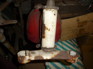

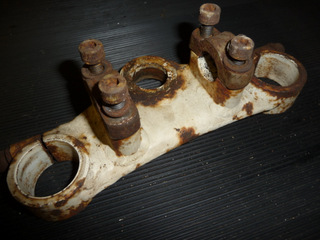

I notice mine is a bit different to Greeves bike,mine has steel fork yokes and the first part of the exhaust was chromed.
Hi Jon
From what I have seen, the early 247 models (mk 1 and 2) had yokes like the ones on Greeves' bike, with the bolts on the side. Later yokes (mk 3 onwards) have the fixing bolts recessed on the front.
Posted Image
I also think that the first part of the exhaust would originally have been chrome
Posted Image
Could you post a picture of the yokes on your bike to have a look at?

Hi
John
My 1968 Cota had the steel yokes finished in Hammered Silver with the side bolts as shown in Chris's picture.
I believe the alloy yokes came in at the same time the mod to the primary drive cover when they removed the extra flywheel and narrowed the engine.
Thank you for the comments on the Mont, makes it all worthwhile.

Here you go,Montesa must have thought the front end was too light to have specced yokes as heavy as that !
I can sell time - but I cant buy it...
