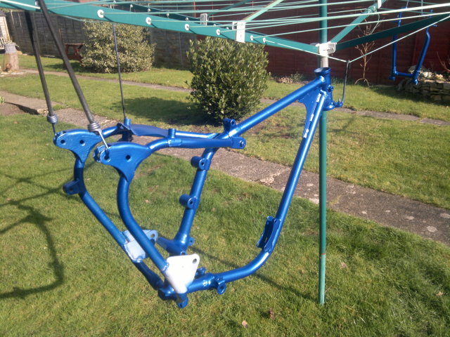

Hi All,
Thought i'd up date the thread with a couple of piccys of progress so far.
Started with this
and this
Got these
and this
a bit of blasting and painting
and a few bits and we're about here
Still a way to go but i'm chuffed with the progress
Cheers
Chris
Edited by ElGringo
Share this post
Link to post
Always wondered what those things in the garden were for !
