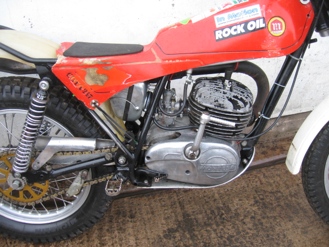

Some of you will know that I have been restoring my early Cota over the past 12 months.
I have been searching for an Electronic Ignition system for the past 6 months, not because the original setup was unreliable, just that I could not be bothered to take the flwheel cover off every week to let the condensation dry out. Then fiddle setting/cleaning/checking the points gap through the flywheel.
Am I lazy? Perhaps but really I just want simpler maintenance and more reliability!
My solution was sorted at Telford, Peter at Elextrec World thought their Montesa 348/9 STK-349 kit may fit but the flywheel weighs 3.7 Kg as opposed to 3KG on my 247.
The kit fitted like a glove, dead simple to time and the bike started second kick and sounds sweet. Tried it at Bath classic today (only 3 sections and half a lap, twisted my back and retired) but the variable advance properties of the system were impressive, giving a very smooth power delivery even with the heavier that standard flywheel.
Will run it this weekend at the West of England SM round before deciding whether to skim the weight off the flywheel.
Hope this is of interest.
Kind regards
Martin

Martin,
Would be great if you can keep this updated as i too was trying to find an electronic ignition for my 79/80 247c as i'm not very mechanically minded and thought it would be much better for me.
What age is your bike - and some pics would be great.
cheers

Martin,
Thanks for that - Mine is the later model with the clutch lever on the top of the casing rather than the underneath.
It's also - Slightly more bashed about than yours - I'll try to post some photo's later in the week.
