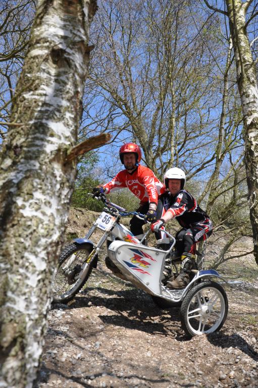

I have attached a photo of a friends TYz outfit to inspire you and I hope you'll post photos of your outfit soon.
