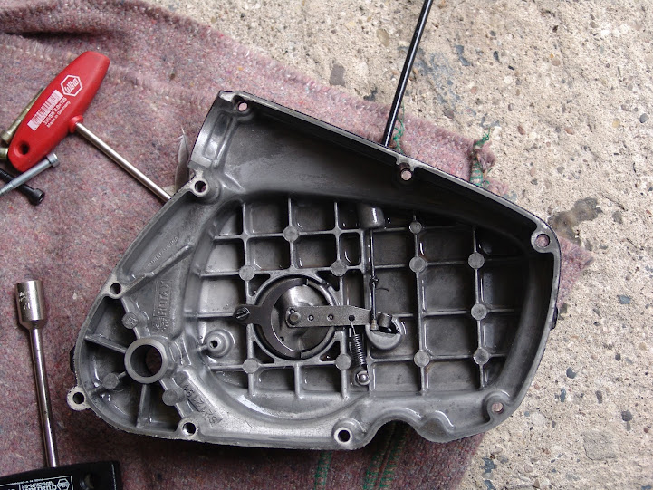

The conversion for the balls has to be done inside the clutch side case:
The inner lever has to be replaced against one that can take up the bigger balls.
Then the ground level of the side case has to be deepened a little bit by milling so the bigger balls will
fit. I sadly just have a photo how it looked before.
