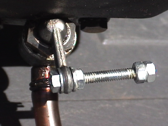

I too bought a 97 section recently, and was pleasently suprised by the bike overall. Mine too seemed hard to start however as previously suggested, a carb clean made all the difference to mine. I also would suggest that you turn off the fuel tap after every use, this is not so easy on my bike as the fuel tap is so tight behind the frame. Is this the same on your bike.

Connor, I had to modify that petcock by drilling the "handle" and putting a 4mmx40mm boly on it.
Hard to explain, works well. I could send a digital photo if you like.

Would you mind forwarding those pic on to ronoc88@hotmail.com or even post em up here. I will have to do something similar with that tap myself.

And sorry for the dlay, but we LOST our digital camera a couple of weeks ago, so I could not post a photo of the fuel tap modification. Today, I used my dogotal camcorder to make a video, and converted that to a still image, so, hope this works!
