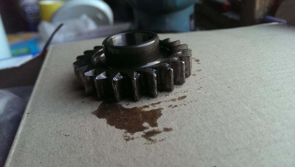

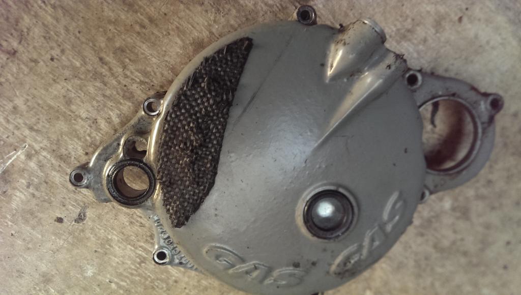

After kicking the bike over and running it for a short while i noticed i was loosing clutch oil once i put it on side stand and that the bike would not tick over at all, unless the choke was fully on. I noticed that there was a bit of play ( about and half inch or so ) on the kickstart shaft. The kickstart spring had burst the clutch casing.

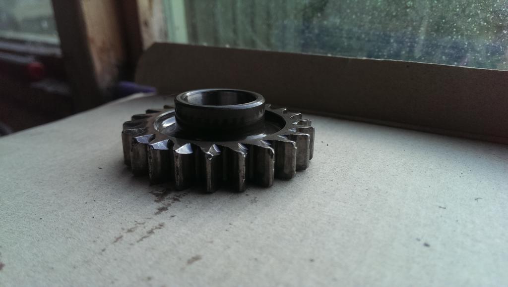

I have removed the clutch plates and housing to look at the idler gear and it is a little chipped and worn around some of the teeth but not too major.
So currently i am planning buying a new clutch casing, gasket, and gear idle cog. I am wondering a couple of things..1: will these actions fix the problem ( the last thing i want to do is kick the bike over and burst a new casing.
2: could the slight wear on the gear idle cog be responsible for the friction kickstart spring bursting through the casing?

What you did not include is a picture of the kick start shaft and pawl gear. This was very common on 02-04 models. There is a new shaft and gear upgrade that is not cheap. Also check the blind bearing in the case. You can get to it from behind the carb more or less.
Link to comment
yeah tht year was a weak point, after that they have made it abit stornger but it still does occur much to our annoyance !!! sometimes when the idler gets chipped if it engages to the clutch basket at a chip or at a bad angle the clutch case will flex and crack or break. this happened on our old 2011 300. ££££

Thanks for your replies.. when i get a minute to spend some more time on it I will post a pic of the kick shaft and pawl gear.
I realise that £££'s will have to be spent, hoping its jst the casing, and idle gear. I really don't want it to happen again once i get it back together.
Lineaway: what should i be looking for on the shaft and pawl gear, just any signs of damage?
Much appreciated advice. Thanks
