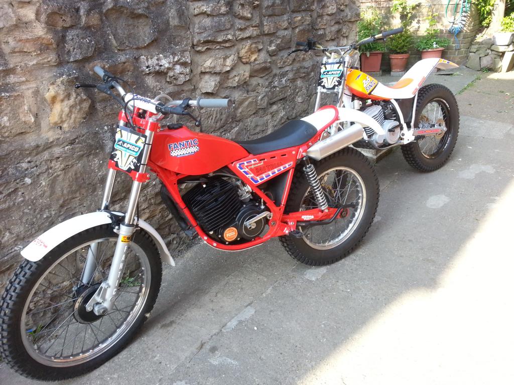

I have an FM 237 200 Forward Kick pro that is in rebuild.
I'm looking for some swinging arm bushes. swinging arm inner 23mm - Spindle 20mm
I had thought they would be the same as a 240 but not so.
I'm led to believe they were just a bronze bush ?? and would they have any end caps.

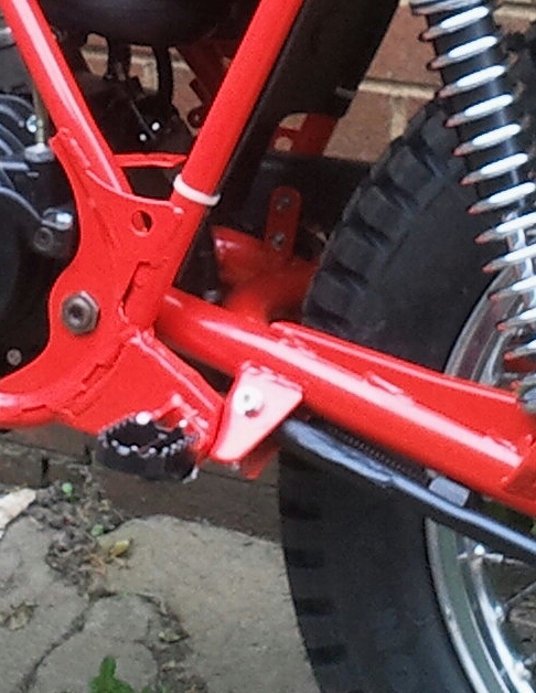

On moving the footpegs back what do you do with your stand - as it seems to be in the way ??
Thanks

Looks a bit tight Andy - I might just cut it off and use a rock to park on !!!
Have you replaced the swinging arm bushes and if so where did you get th from??
Any chance of a couple of full size pictures ??
Standard air box and what about exhaust ??
25 mm carb ??
Thanks
The wobbler
Link to comment
I had a 125 forward kick (200 pro for a while ) swinging arm bushes are different too the 240 ones , i bought some bronze bushes with plastic inners ( Steve Goode or was it Bob wright ) a few years back , swinging arm pin's are the same at 20mm . Mine run with the standard front exhaust , with wes alloy back box , standard airbox , but run better with the 125 24mm carb .

Hi wobbler
240 fantic, I changed the swinging arm pin but the bushes i had made by a friend who also did frame mods, i ran a standard airbox, 26mm carb but with new slide, needle and needle jet, tail pipe looks like a wes but was actually made by Bill Pye, 5 series 35mm forks, head angle and footrest mods and also a after market tank, i sold this bike recently to fund another project, big mistake!

Andy,
looks great - I think i'll just go with the Bronze Bushes for the minute.
Can you remember the jetting etc for the carb.
I'm doing the footpegs but not the head angle - My 240 is fine with the top yoke adjusted - What size chain and what teeth sprockets did you use ??
My 240 - (tatty but built to Ride !!)
Link to comment
I think i just ran 98 main with a 40 pilot jet ,but when i rebuilt mine it ran very rich so i tried a oko carb but struggled with that to, in the end i replaced the 30 yr old slide, needle jet and needle with new parts and after that it ran spot on, the bits worked out about £40 which is less than half the price of a new carb! as for gearing i ran a 520 chain on 11/42 sprockets.
