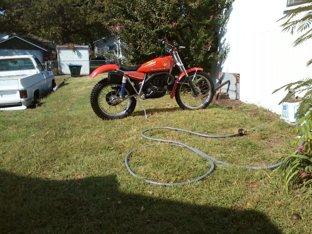

[ attachment=14930:Picture0114151936_1.jpg]Just one of the girls standing out in the sun with nothing to do.

You have done a nice job on those Sherpa T,s Larry.I had a 92 that I regret selling,but it didn,t look as nice as yours.I ,m not sure,but in the picture it looks like yours is minus the bottom frame rails and maybe has a plated finish.Is it a SM frame? I also like the truck in the first picture.I,ve been looking for one here but they,re always too rusted or they want crazy money for them.
Cheers, Scott

Scott,
The Mod 92 does have Miller frame #29x, it was I think 1 of 3 around here in 1973 that broke the front down tube @ the lower
edge of the gusset, I traded a titanium rear axel for it, tubed inside & welded back, cut the gusset per factory spec. and off we go.
Had to do something to dampen the shaking engine (no head steady back then) so after engine mounts started cracking, added
a turn buckle from front head bolt to frame gusset, stopped that foolishness.
It lives @ my son's home now.
The old truck 75 3/4 Chev. bought new, bike hauler ect.
Larry
