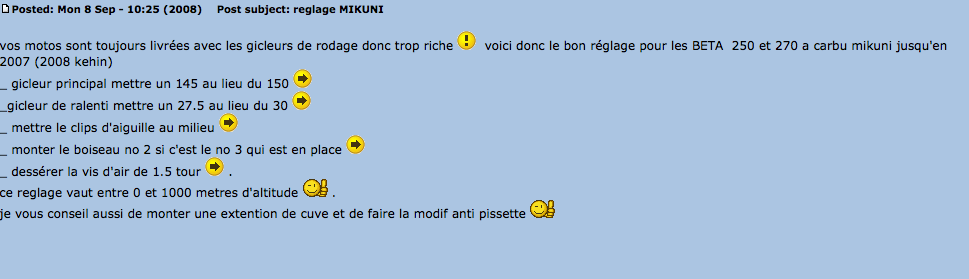

Fitting A 2006 Rev3 270 With The Keihin Pwk 28 Carb
podracer
Says he`s using a 145 and 27.5 up to 1000m and 2nd clip down, air screw 1,5 turns out
Yep , I saw That too,
But the last sentece I dont get it ...
Extention de cuve ???
And also ¨ Monter le boiseu no 2 si cest le no 3 qui est en place ??

Extention de cuve.?.
There was a carb extension used on the bowl of the Mikuni by some of the top riders. Never saw it did much good. Funny that article it came from then referred to the Billy T carb fix.
