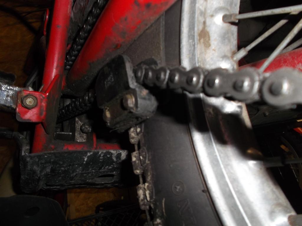

Got it back together - but the chain tensioner is defiantly wrong - can any body post a picture of one - either fitted or off the bike ??

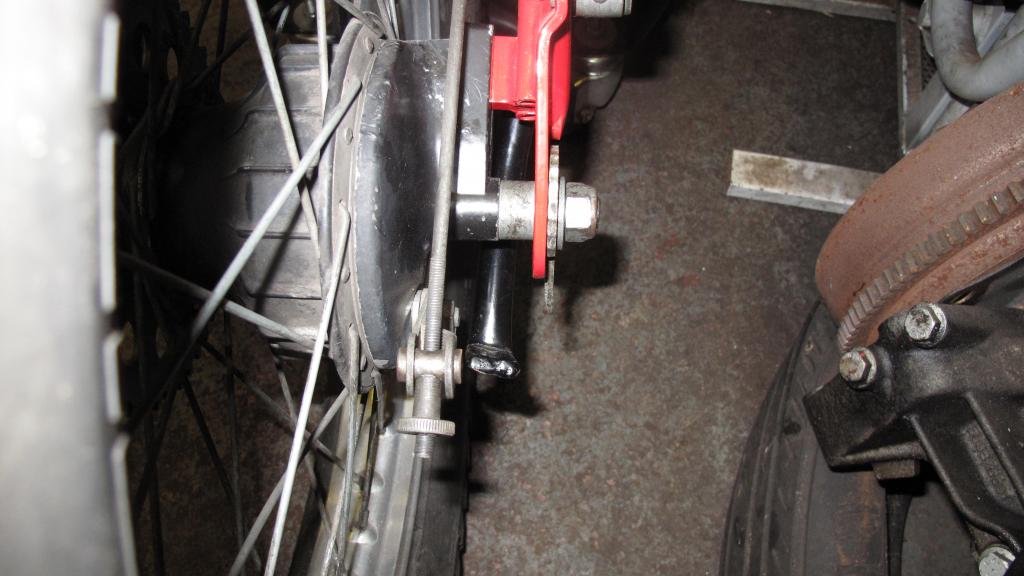

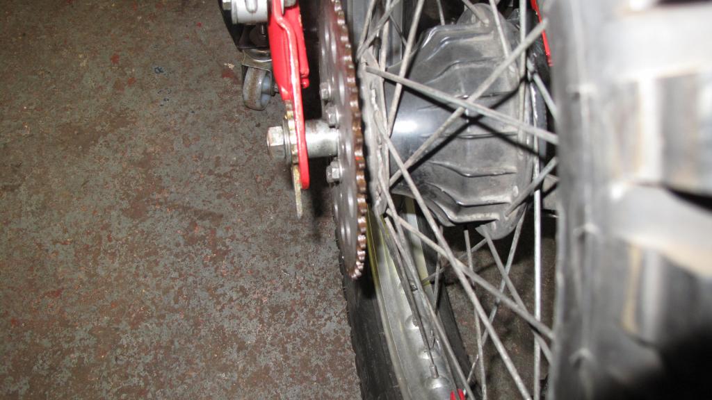

Well here you go .... I just ran out to the shop , in the rain , and kicked the alligator on my way . But without moving everything out there and just pointing and shooting , here you go . I don't remember how how I geared it , but I did convert it to the next larger chain size thru France trial classic , 420 I think . And I left the springs stock with 10wt , as it was being set up for my 110lb daughter .
Have fun , I hope this helps .
Glenn
