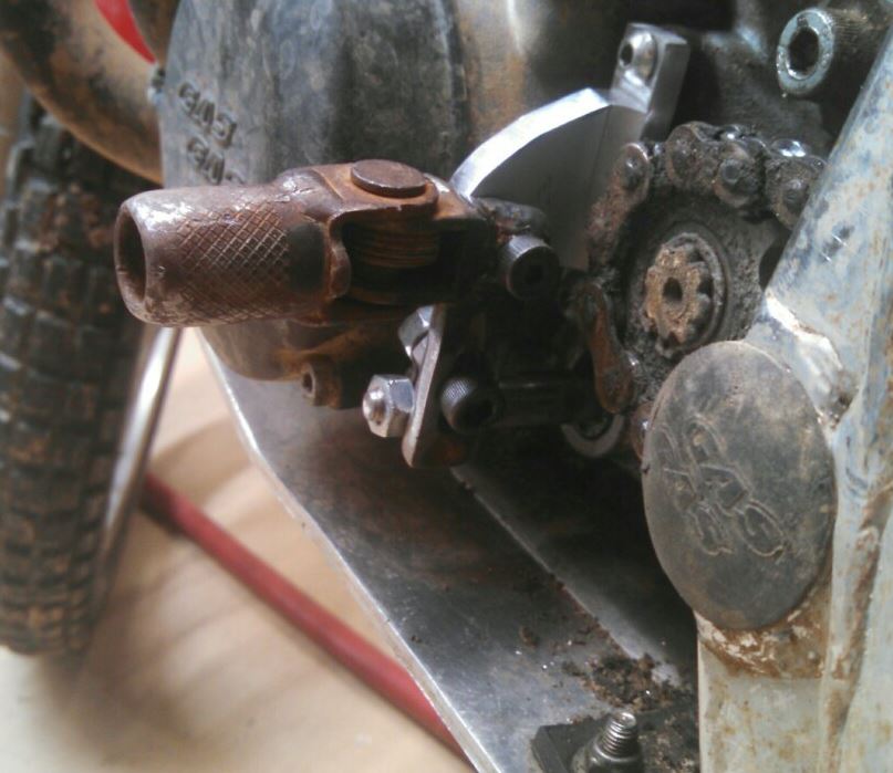

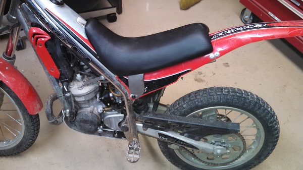

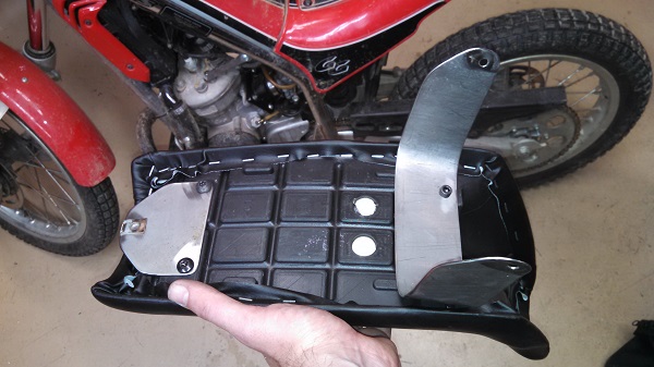

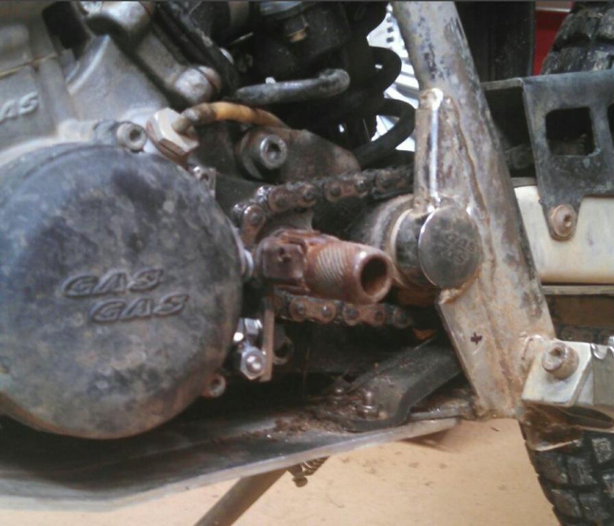

I made a toe shift linkage and I put a PW50 seat on it.  We trail ride for 3 day weekends and he needs a place to sit.
the PW50 seat required only a couple scraps of 12 gage steel to attach using a few pan head screws to the stock locations.
the shift linkage involves unscrewing teh thumb knob and sprocket cover and making a simple lever and mounting plate to activate the shift shaft.
