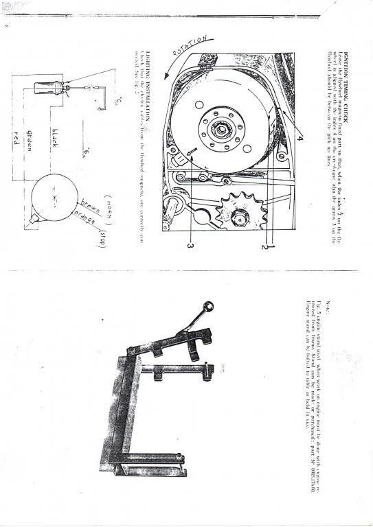

hi , what is the correct procedure for accurately setting up the ignition timing please on my 200 minerelli ?  Also is the ignition module ( later type ) the same for all Fantics ? for example is a 300 one the same as a 200 one ? . Thanks if you can help .

The 1st attachment is from a 200 rebuild manual I got some years ago. I've used this to set both the Minerelli engines on my 200's.
The earlier bikes like the 200 (FM350) and 125 (FM250) had a Dansi ignition set up. Pretty sure this had changed by the time the 300 arrived, but can't be 100% certain on that one.
The 2nd attachment is from the original parts book for the 200.It shows the ref for the module, hope this helps.
