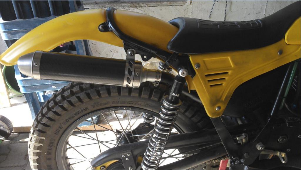

I tried this Giannelli on my 125 for a while. I liked it, was a little louder than the standard box and I felt that the motor was a bit livelier. Now have the standard box back on as too many people past comments regarding the modern looks and the noise.
