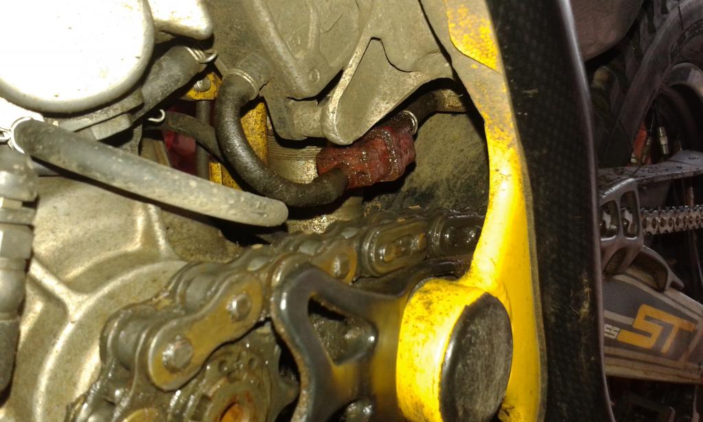

2.  Fit an in-line fuel filter.  One of these small ones from e.bay works well on a 125.  £2.00.  250/300cc might need a larger one.
http://www.ebay.co.uk/itm/Universal-Motorcycle-Bike-Engine-Fram-Plastic-Inline-Mini-Small-Fuel-Gas-Filte/251712866901?_trksid=p2047675.c100005.m1851&_trkparms=aid%3D222007%26algo%3DSIC.MBE%26ao%3D1%26asc%3D36823%26meid%3D81696840dcbd4a2aa4b07eda01fde0e1%26pid%3D100005%26rk%3D2%26rkt%3D3%26sd%3D301972249841
