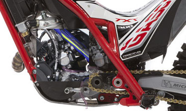

I've had a similar issue with the bike blubbering on downhills on my Beta with a Keihin PW28 and now I'm having it on my 125 TXT Pro. I've stripped and cleaned the carb, made sure the jetting is correct for my riding locations and also adjusted the air mixture screw to around 2.5 turns out and I've got the floats level with the casting at around 18 mm when held at 45 degrees. Raising the idle seems to help and I've veried the RPM on the Hardline Tacho which is reading around 1,400-1,500 RPM (bike in neutral/flat surface) to stop it from blubbering on downhills... is this normal?

This is how I was running it originally around 20.5 mm and inline with the casting mark under the jet holder. It didn't solve the problem, I believe this recommended is only to avoid overflowing of the carb on steep descents which results in reducing the amount of fuel lost out of the overflow pipe.
This recommendation from splatshop is also a recommendation for their experiences with Sherco bikes which I believe have a slightly steeper carb angle compared to the Gas Gas. I've quickly superimposed the 2015 Sherco and Gas Gas bikes with equal sized dimensions and this seems to be the case.
