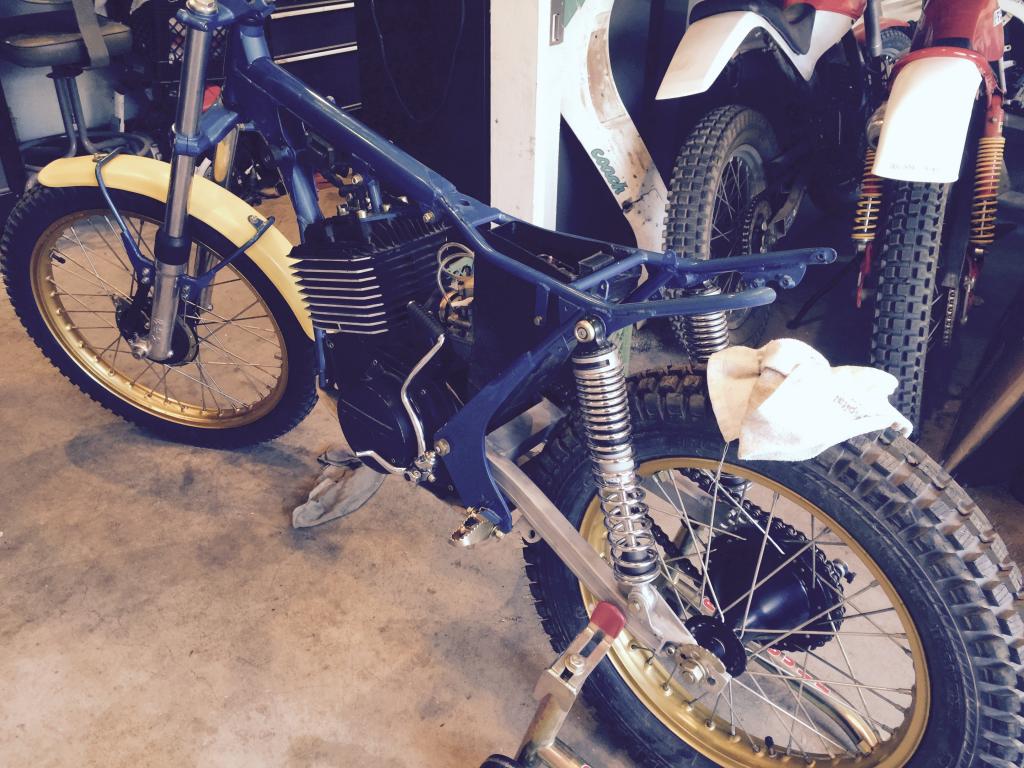

About 20% into my Jumbo 350 project when I bought someone else's 85% finished project.  I'll finish it first and then eventually get to the original one.
Unfortunately I must have mistakenly deleted all my tear down photos and will probably be poking in occasionally with questions. I looked all over the web but can't find a pic of the skid plate rear mount. I got a new plate from Martin which would crash into the engine case unless there are spacers between the rear mount and the plate. I'm figuring about 12mm of space is needed. Is this right? Am I missing something? Any help w
