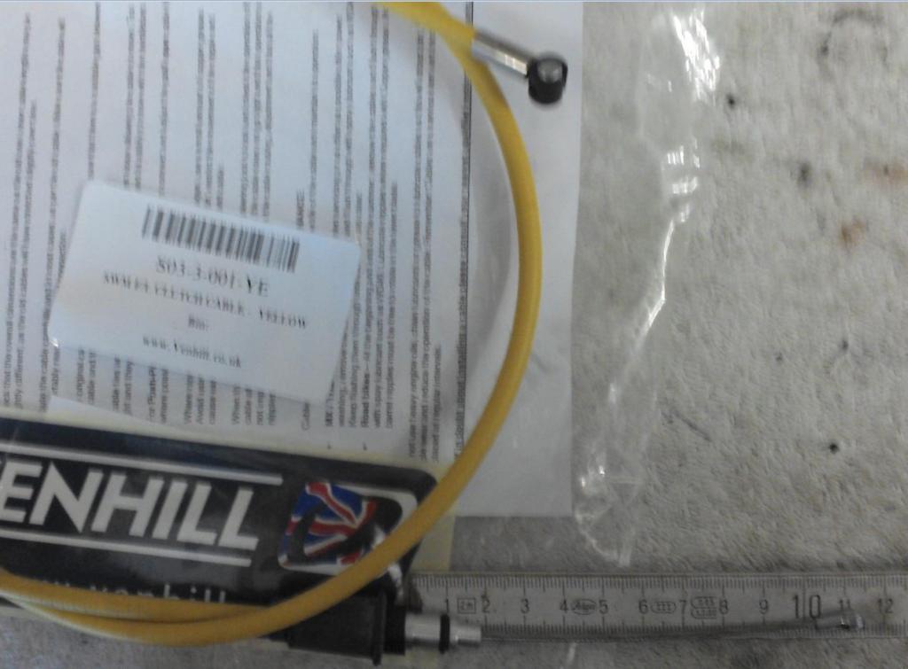

Hi, here's a picture of the Venhill clutch cable and the length of the inner. This cable fits my 80 125 with a lengthened arm and my 81 320 with the Aprillia arm conversion ( see separate threads for pics, Barnett Clutches).
The clutch lightness is ok but it's not a one/two finger thing. A hardly use it anyway so that's not a problem for me.

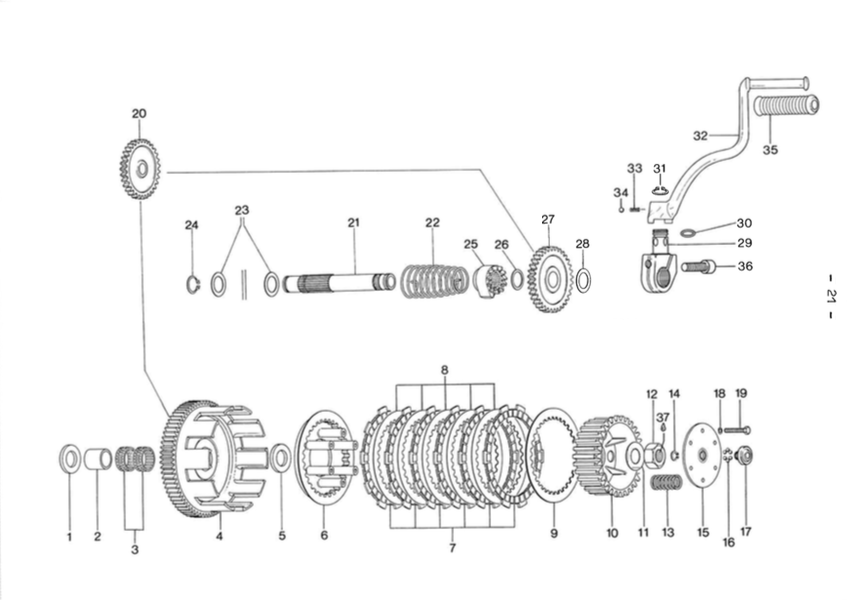

1. Are you using Domino levers...if not you may need to alter the cable.
2. Is everything assembled as shown in the attached diagram....is the thrust plate the correct way round, are there 2 x 3mm thick washers either side of the bearing/basket, do you have 6 friction plates, separated by 5 x 1mm thick metal plates and one 1.5mm metal plate on the outside of the basket.
3. Is the clutch adjusted correctly. Slacken off the cable ant the handlebar end. Wind in the grub screw on the clutch arm until it just touches the thrust plate, then take up the slack at the lever end. Use this as a starting point and adjust the grub screw by a quarter turn at a time until it frees off and doesn't slip....but remember to slacken off at the handlebar end every time you adjust.
