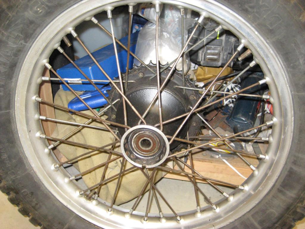

Re the front wheel : do stay with the X-3 spoking pattern - both sides.
The nearest thing I have to an original, unmolested front wheel is this one :
It's not a wheel that I've rebuilt, and as near as I can tell has not been rebuilt by a p.o. (So "original" that I had
to replace the tyre a couple of weeks ago, as the old one had completely rotted away !)
OK, it's a Pursang - flanged rim, etc. but it uses the same spokes as a Sherpa, and consequently the same
spoking pattern. (It's also the same pattern as used in the three mod. 199 wheels I referred to in my last
posting.)
Hopes this helps.

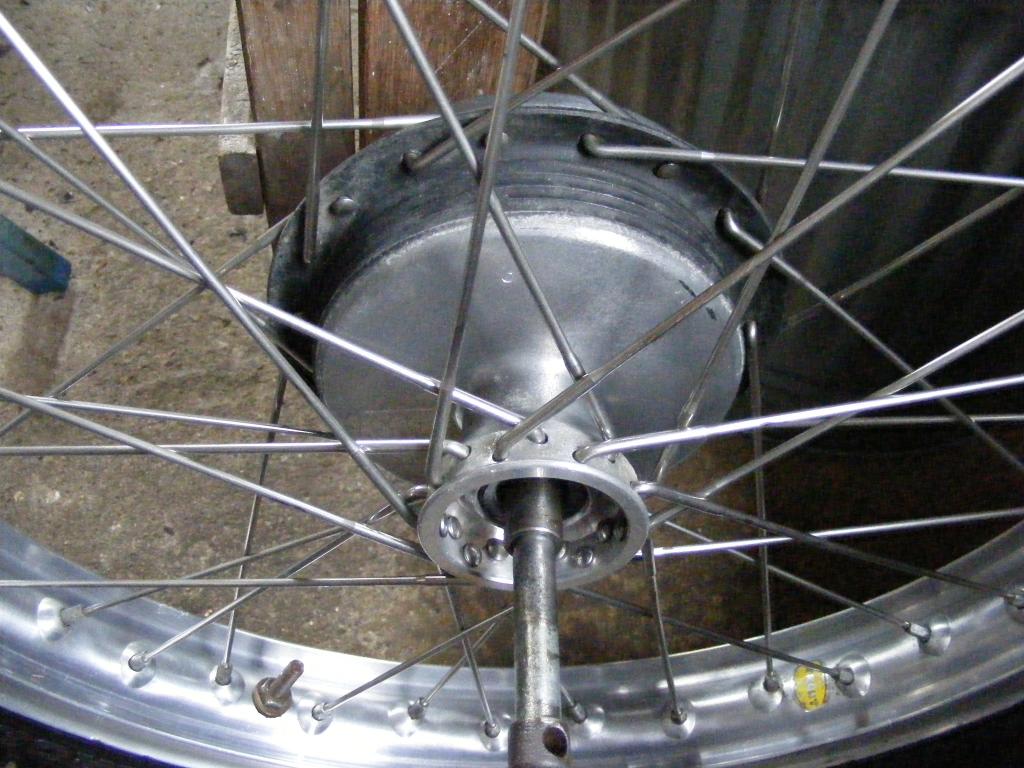

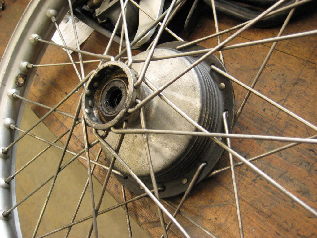

Just stripped an original 199B ready for rebuild.  I have sketched wheel offsets prior to re-spoking (as attached) and these match those measured on my 199A and 198B, all of them having the wheels in the middle of the fork legs/swinging arm, which is important!
Now to spoke lengths.  My new ones from that well-known supplier who shall remain nameless (let's call him Dave, Pete or Robin for arguments sake!) are the following lengths, measured from the centre of the head (pre-bent stainless spokes) to the end of the threaded portion.
Front: 225mm, 228mm and 244mm, slightly different from Lorenzo's information.  Rear: 181mm and 202mm.
Finally to spoke patterns.  I attach a photo of each wheel for your information.  Be careful when putting the spokes in.  The pattern is obviously important but so is the position of the rim in order to get the angle of the spoke in line with the nipple indent on the rim.  It's easy to get this wrong, so just double-check before tightening anything up!
Nowt's easy, but the finished article is worth it.  Happy knitting.
