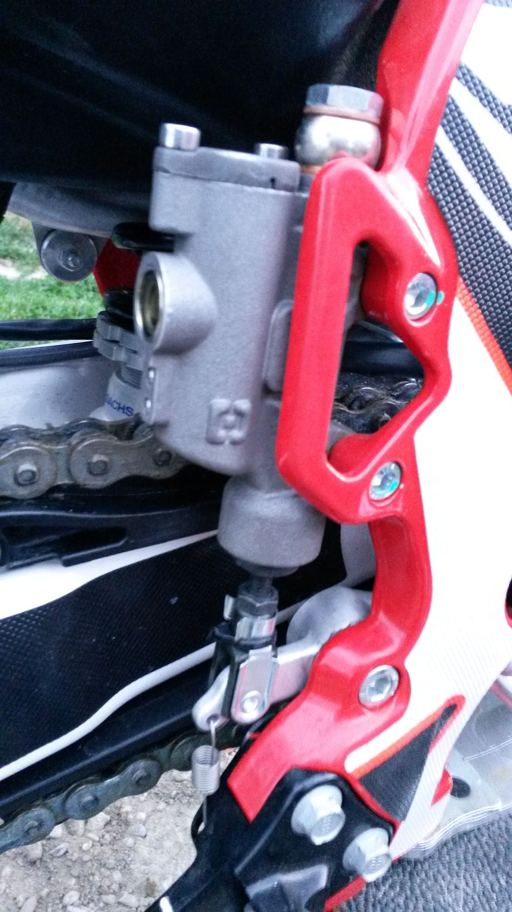

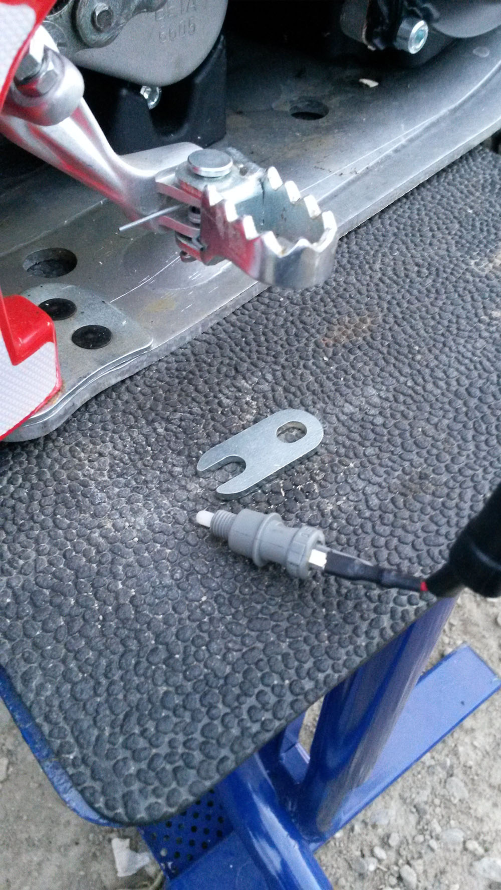

I'm trying to prepare my Beta Evo to be road-legal to pass inspection in order to register it. I've put everything on it (lights, signals etc) except the sensor/switch that turns on the back light when rear-braking. I just can't figure it out how/where it needs to be placed. Any ideas? Here's some pictures:

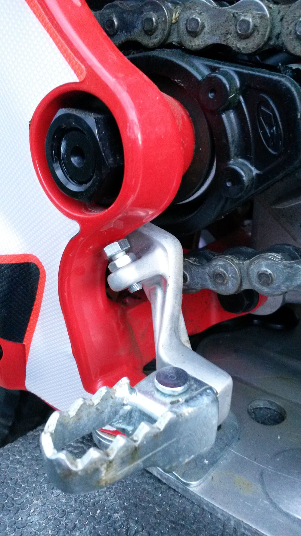

Only place I see that would work is on stop adjuster bolt on pedal. Switch would hit frame above pedal. Switch would have to be normally closed type opening when pedal Is up and switch hits frame.

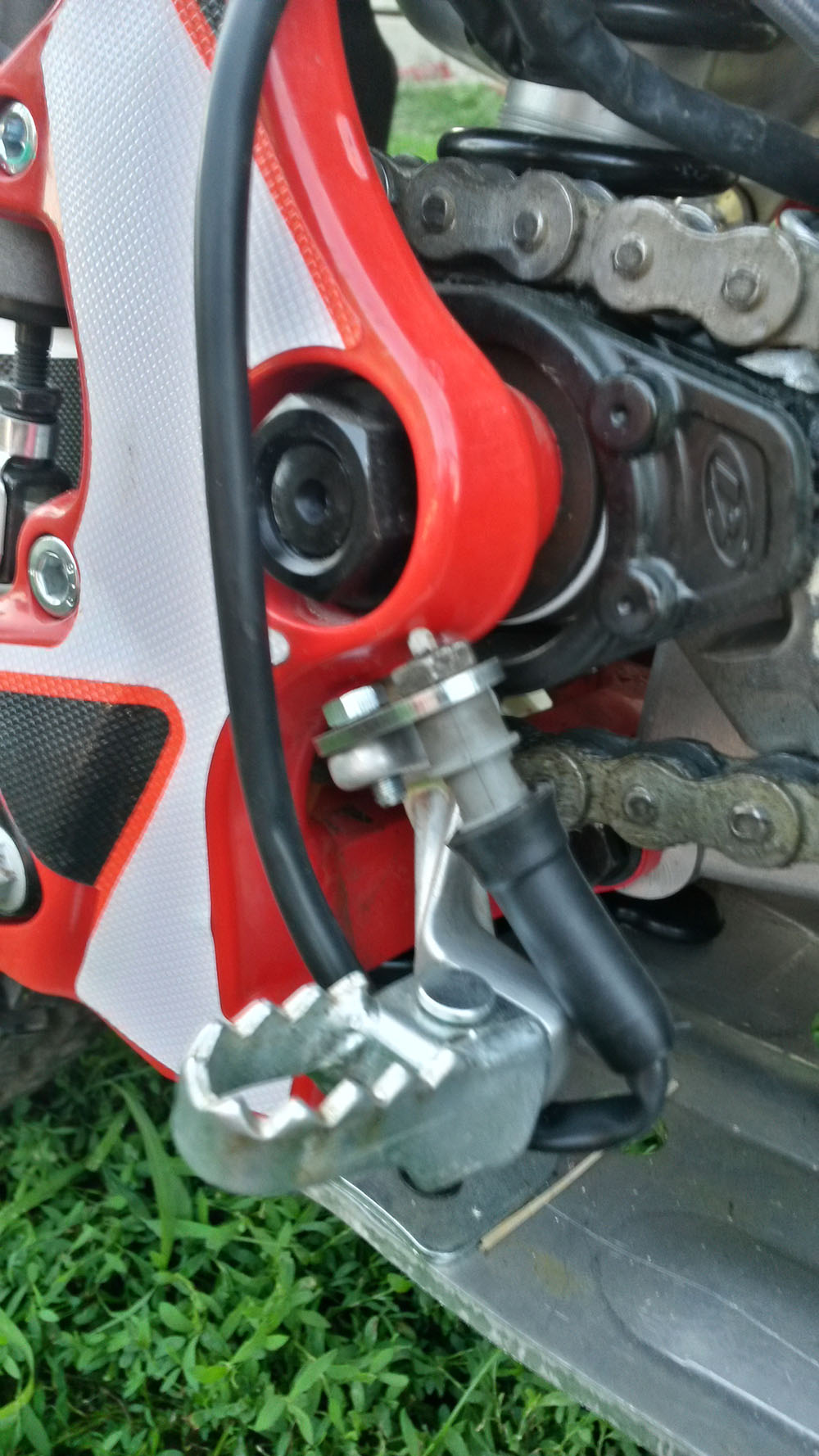

I ended up doing it like in the attached picture. Not ideal maybe, but just to pass inspection did the trick.
