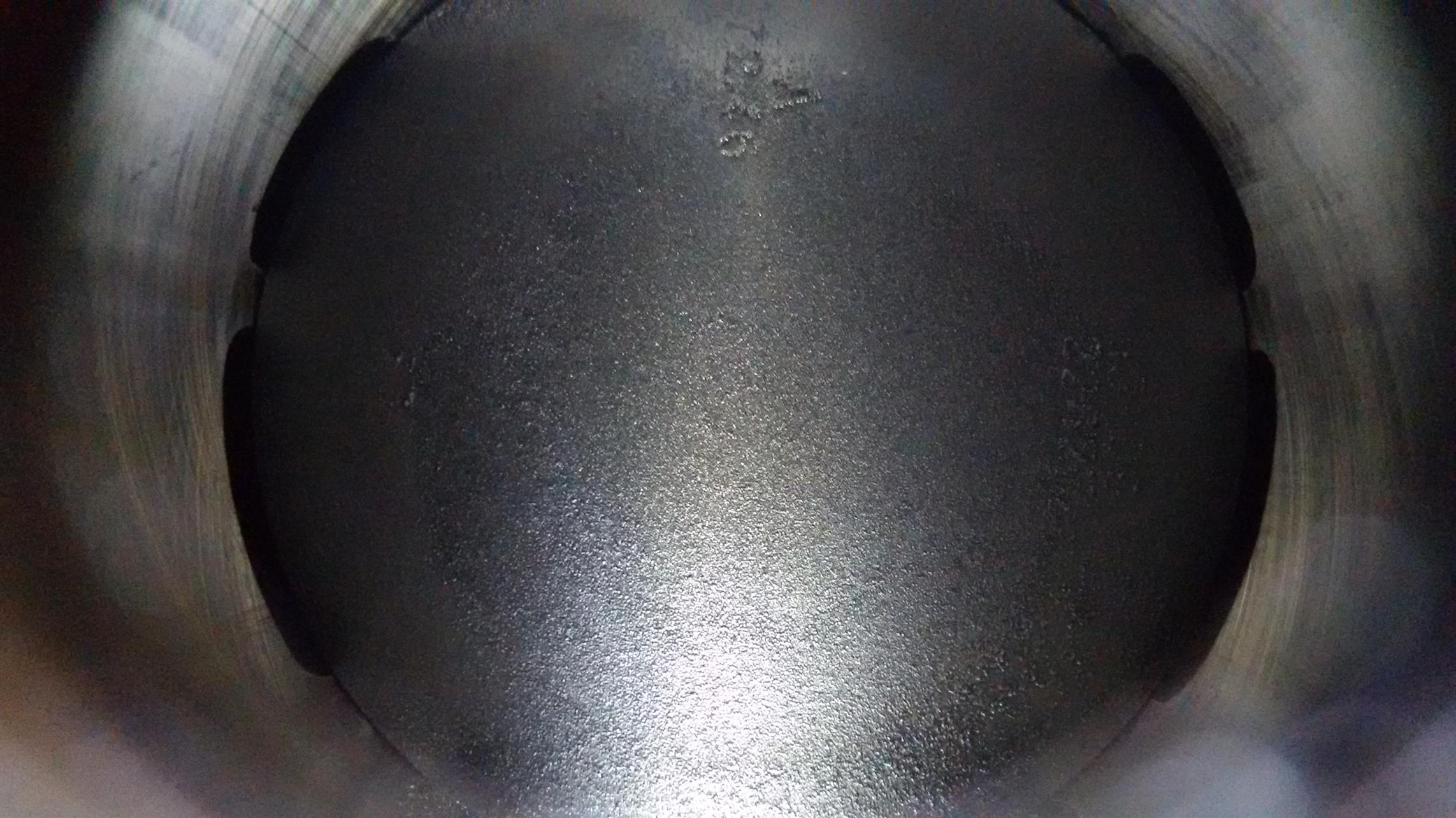

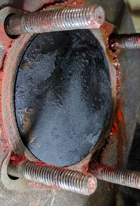

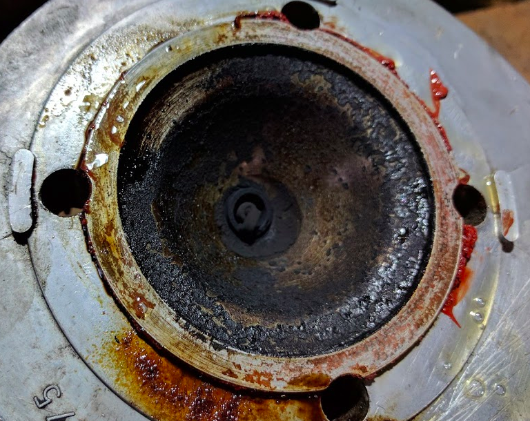

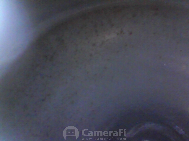

There is some good information above - see beta-blocker. With regard Maxima 927, I too use Maxima 927 and researched it before decision to use. Yes, there is past history of sticking ring grooves etc etc but reading (yes, from the manufacturer who acknowledges that history) these issues may well be past history. I converted to Maxima 927 18 months ago after a long history of using two well known brands used in trials bikes. Why did I investigate and change - some of it was "advice" given by others that they would never use X brand because someone they knew seized their engine and then for the other brand having pulled apart my motor for another reason (one ball bearing delaminating in a well known and respected bearing manufacturer in an engine lubricated by a well respected transmission oil for trials bikes) I found the piston crown with a hard encrusted black carbon, compression dome similarly encrusted and rings and ring grooves horribly gummed up having used a common respected trials pre-mix oil at 100:1 (as recommended by the factory). After much research and some discussion with others, I converted to Maxima 927.
Find attached images of my piston crown and the compression dome after 18 months of use (~100 hours of riding) since previous tear-down (pics taken through the spark plug and by a USB micro camera pointed up from the exhaust port. To be able to still see the size of the piston (see attached image) and, in other pics I have, to see the manufacturing date etc of the piston and to see the clean compression dome (see attached) gave me confidence to continue. As I had the exhaust off (I needed to get the bash plate off) I also took pics of the rings & grooves through the exhaust and they were also very clean (unfortunately I must have deleted them). I use 80:1 pre-mix, (no more than 5L mixed at a time), the plug is a coffee brown colour and I have spent time on carburation and not over-oiling air-filter and my exhaust header did not appear any blacker or encrusted than I have had in the past. The downside is that I cannot use anyone else's synthetic fuel if I run out - the upside, they cannot borrow mine.
So, while there is a perhaps history for those using castor based oil including gumming up rings and grooves, that may not appear to be the current state of affairs, perhaps things have moved on - after all, I started riding trials when 25:1 or 32:1 was standard and using 50:1 was "way out there" in an aircooled engine. I have obviously moved on.

I'll get my coat.............And if that's what the engine internals look like I am off to buy a bottle of Maxima 927 and advise that every one else does aswell.
