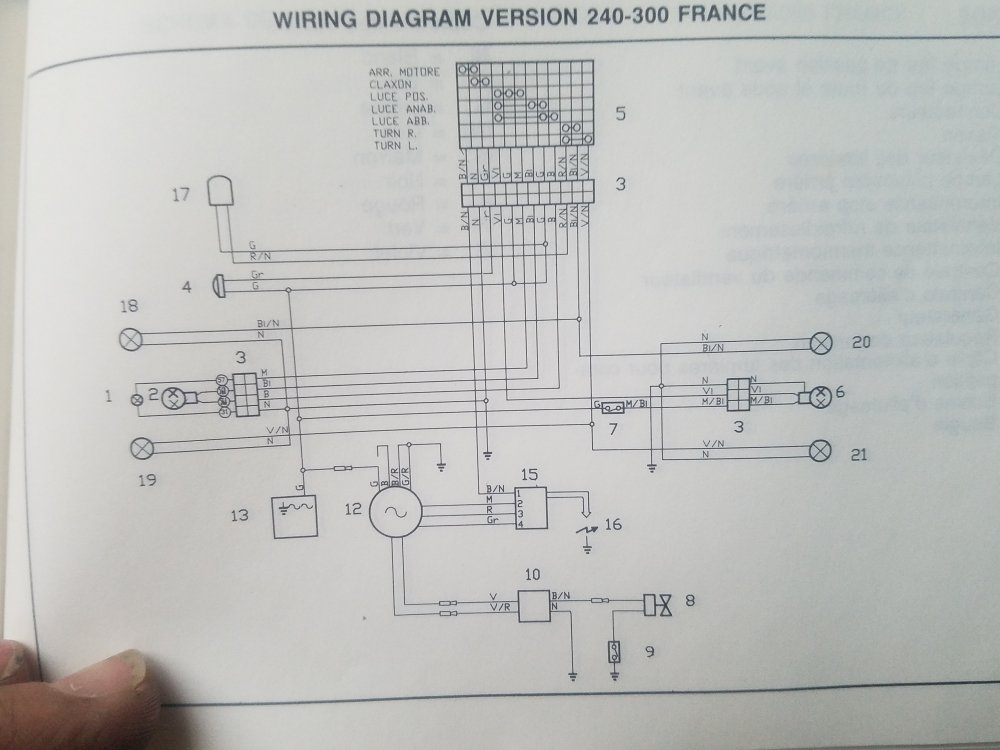

Hi im Dale from the northest of england,ive recently purchased an Aprilia 280 climber.
I was wondering where i could get a wiring diagram or workshop manual, if anyone can help it would be appricated.
Thanks in advance.

16 plug
15 ignition coil
13 voltage regulator
12 generator
11 ignition unit
10 fan control
9 thermometric switch
8 fan
3 connectors
1-7 just lights
14 lights power supply

Do you know if there are any other stators that would be compatable with the 280 climber?.I think mines goosed or the cdi/coil is.😂
