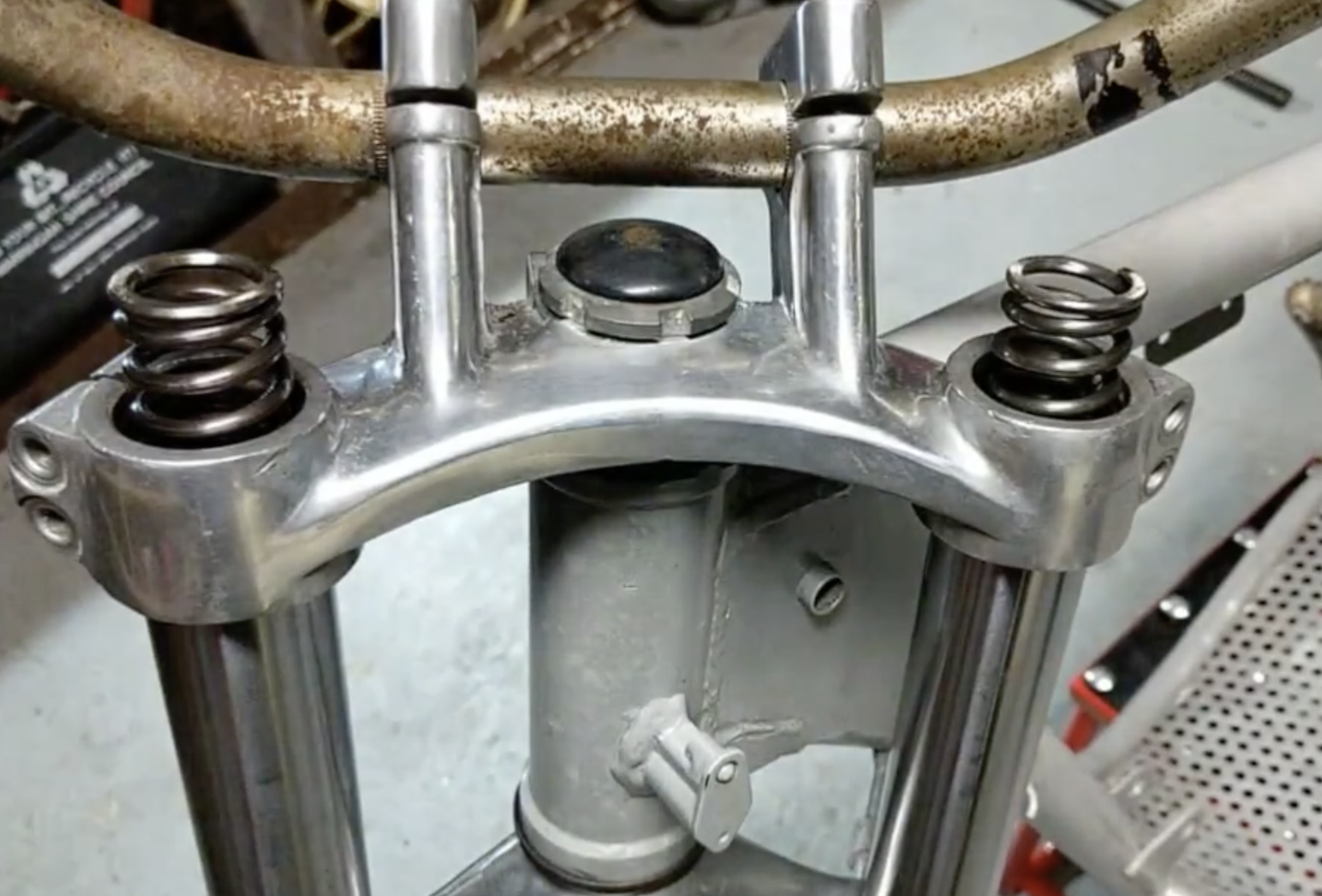

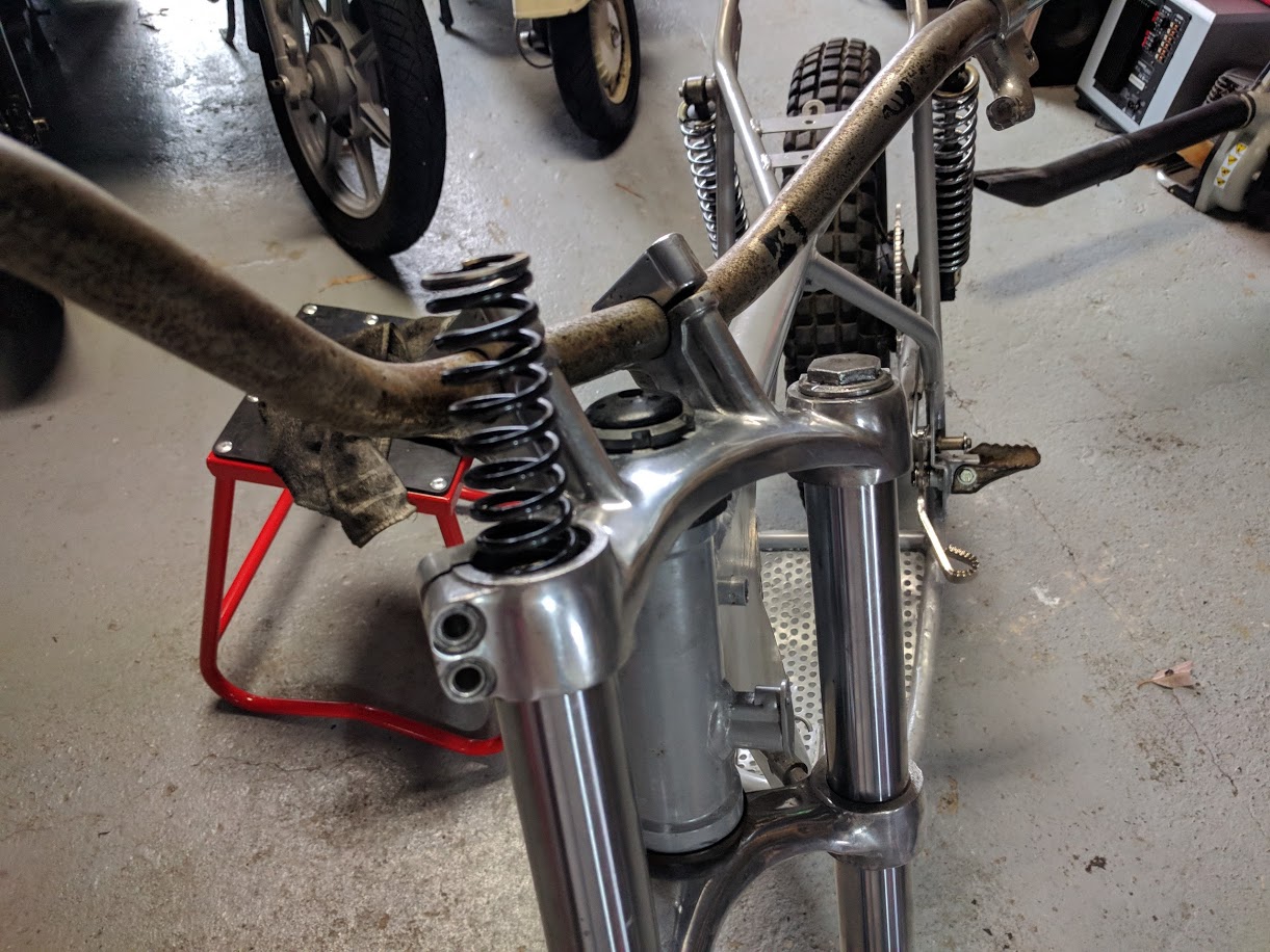

I have purchased some new fork springs for my #158 Sherpa T 250 which are just over 500mm long and are so stiff when I install them that I can hardly compress the front end.
My bike only came with one spring so I can't compare compression but the one old spring I have is about 450mm (50mm shorter) and comes up to the top of the tube when I remove the top cap. These new ones stick right out and it's a real struggle to the get the top caps on. The reseller tells me these springs are correct for this bike and something else must be wrong with the fork.

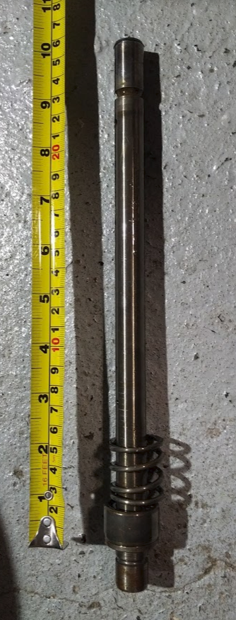

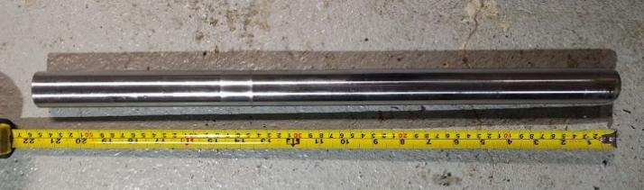

So, I took the fork apart and it all look ok, perhaps I have incorrect length damper rods. The top tubes are 550mm and the damping rod assembly is 100mm
My old Sherpa had very plush forks, and I tried another over the weekend that was also plush. This thing is rock hard with these springs in.
Any help appreciated, especially the length of the springs I need.

The M158, 182, 190  250's have shorter sets of forks than other sherpas and I would assume they need different shorter springs. I am not sure of the actual measurement but your supplier should have known that. My guess would be the springs protrude about 20-25mm out of the top triple clamp before assembly, which is a lot less then yours. Inmotion list Sherpa forks at 500mm so I reckon you have springs for the standard forks and the 450mm one in the bike was the correct length original.

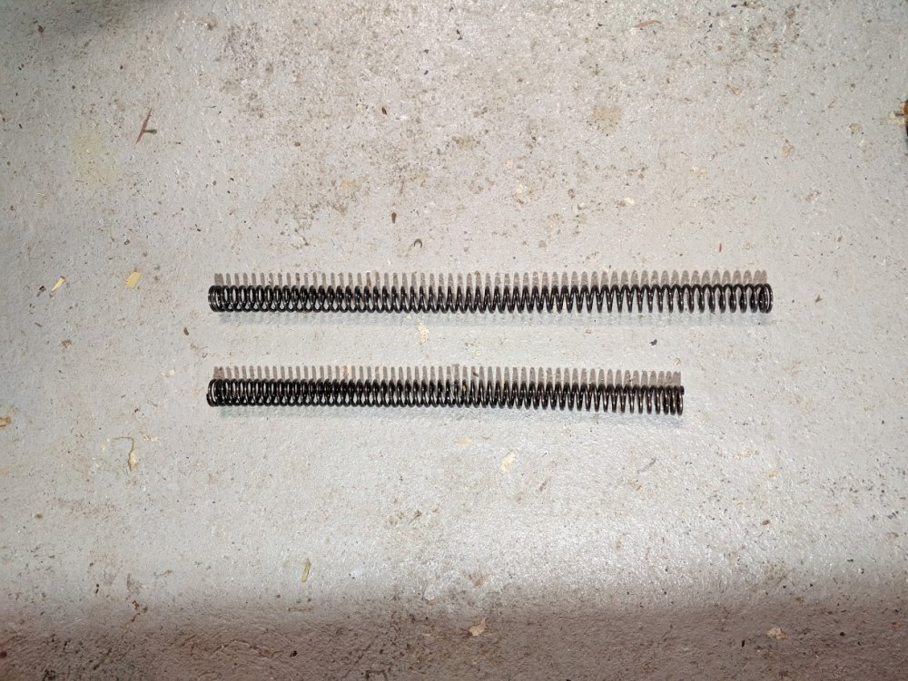

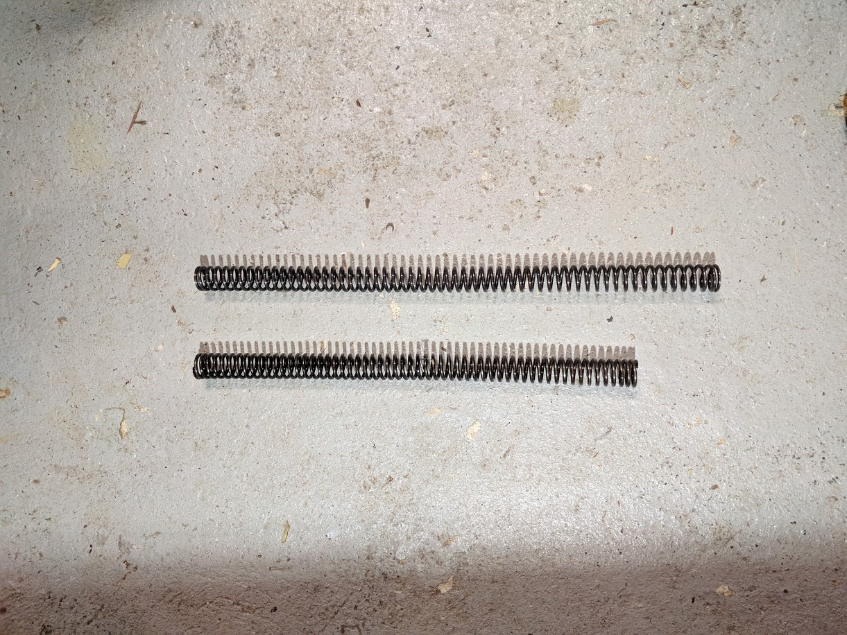

I think the 158 182 190 tubes are only about 10mm shorter but the rods are also 10mm shorter as well so they use the same length springs as the 350’s of that era or maybe even all Sherpas
Id probably just cut those 500+ Pursang  springs down to a suitable length
All the sherpa springs I’ve measured are between 450 to 475mm long

  I had a quick look in my shed and found two leftover springs
one is 475mm long  59 coils and 3.9mm dia steel
the second is 463mm long 50 coils and 3.4 dia     -so a fair bit softer
I can remember trying some Alpina springs back in the day so the longer one could be Alpina but I am not sure

I think I'll just shorten the springs to around 475 and adjust from there, like the idea of the grinder, I hadn't thought of that.

Oh and the selling that was in the bike was 150mm long, 59 coils, 3.7mm wire thickness. Different again. 🤨

All good now though, I shortened the new springs to 475mm and it feels a lot better. I will wait till I get the engine in and then set the sag properly, possibly by taking a little more off.
