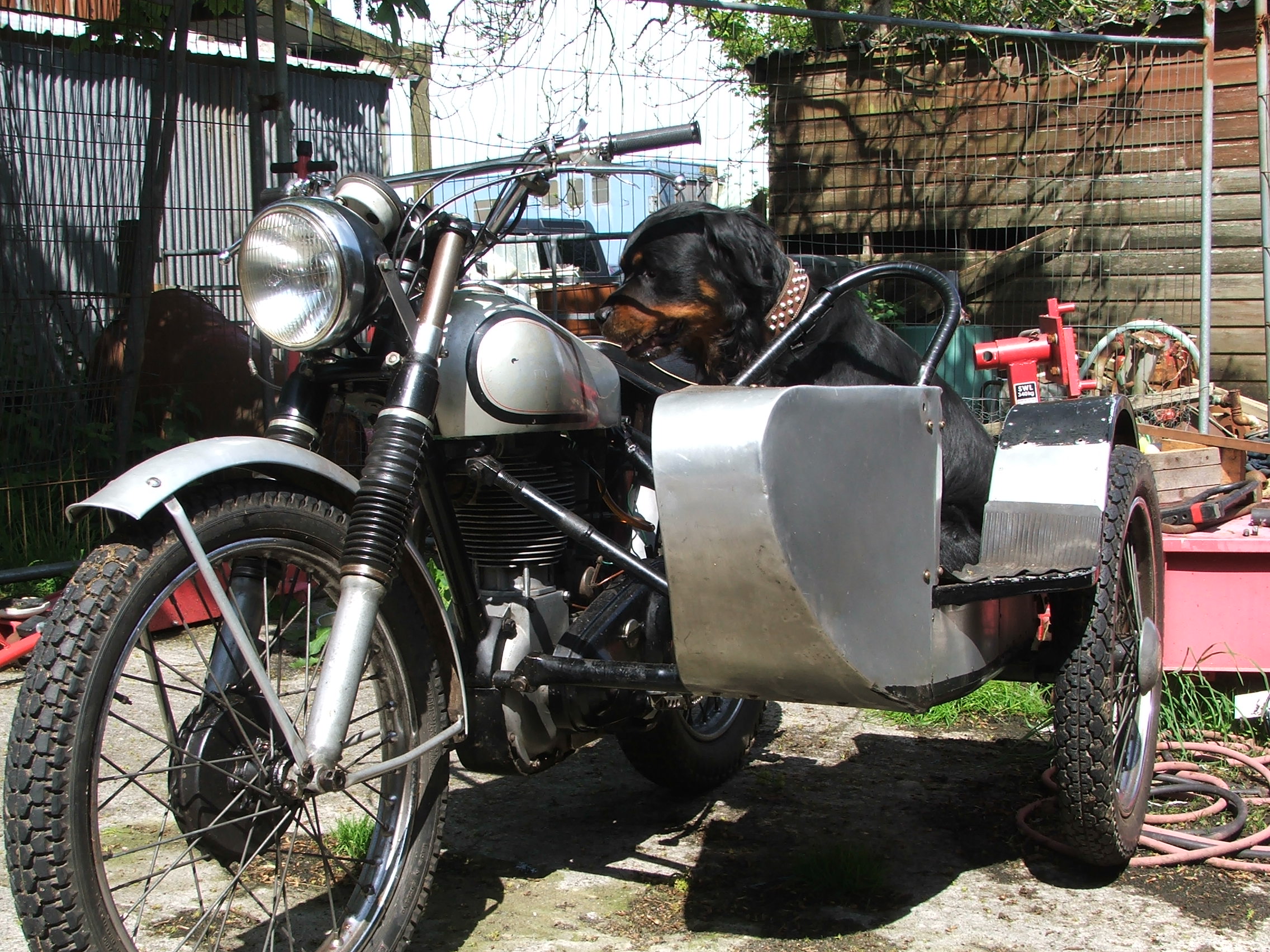

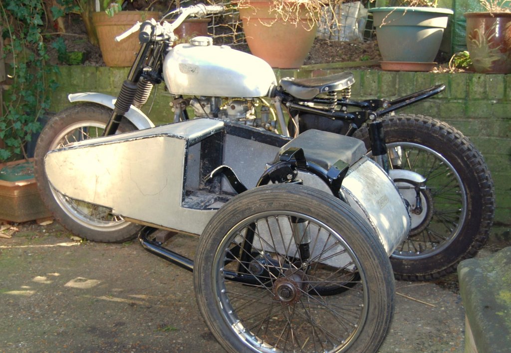

Bryn, I think that you misread my post. I actually have a complete Canterbury trials sidecar on a bike in regular use. Does yours have the Canterbury script on the hub? Here is a picture of mine: I can take some measurements/photos if you think that yours may be the same chassis
Rod

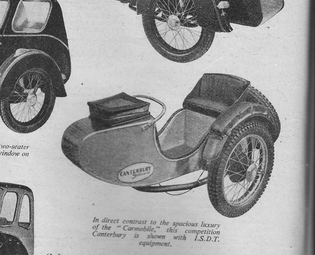

Thanks for your help. It looks as if your Canterbury has been modified quite a bit too. I have attached a picture of the standard version, and mine in it's present state.

My chassis has same small dish on outer hub but unfortunately no stamping (Swallow had similar looking at images). Chassis couplings are stamped CS5. Sidecar wheel coupling is rigid and unsprung though. Any ideas?

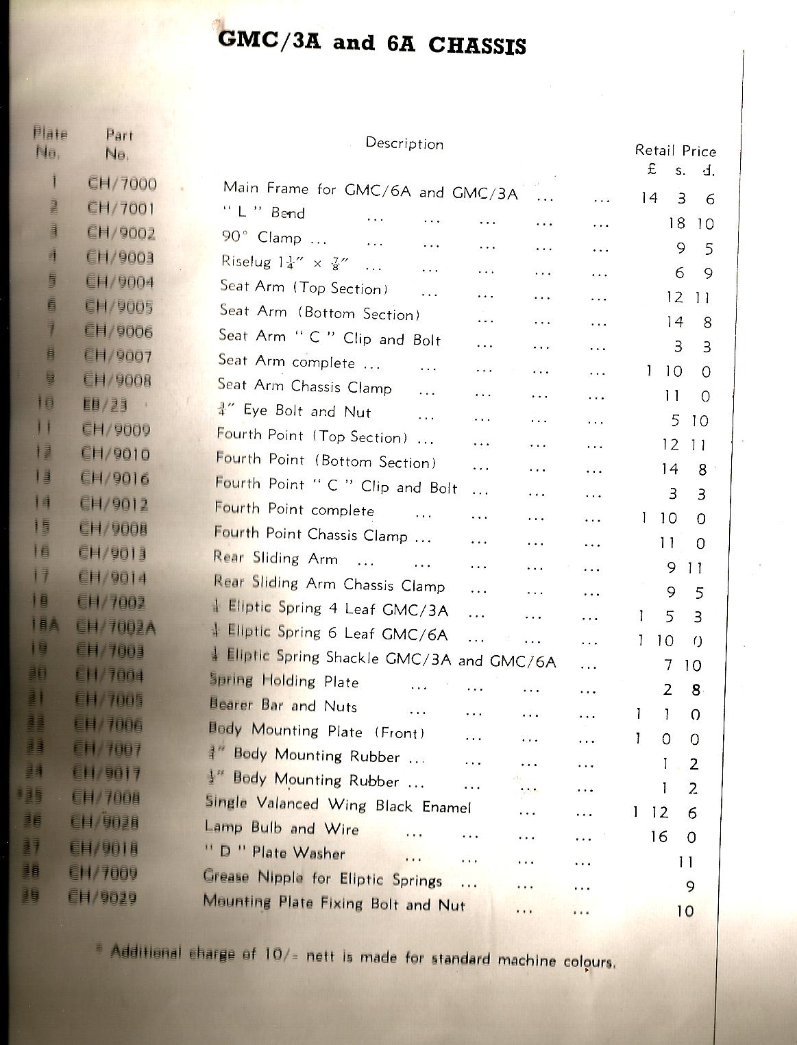

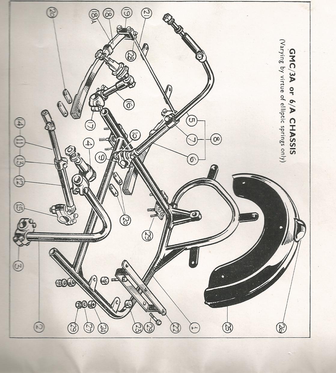

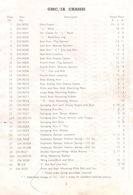

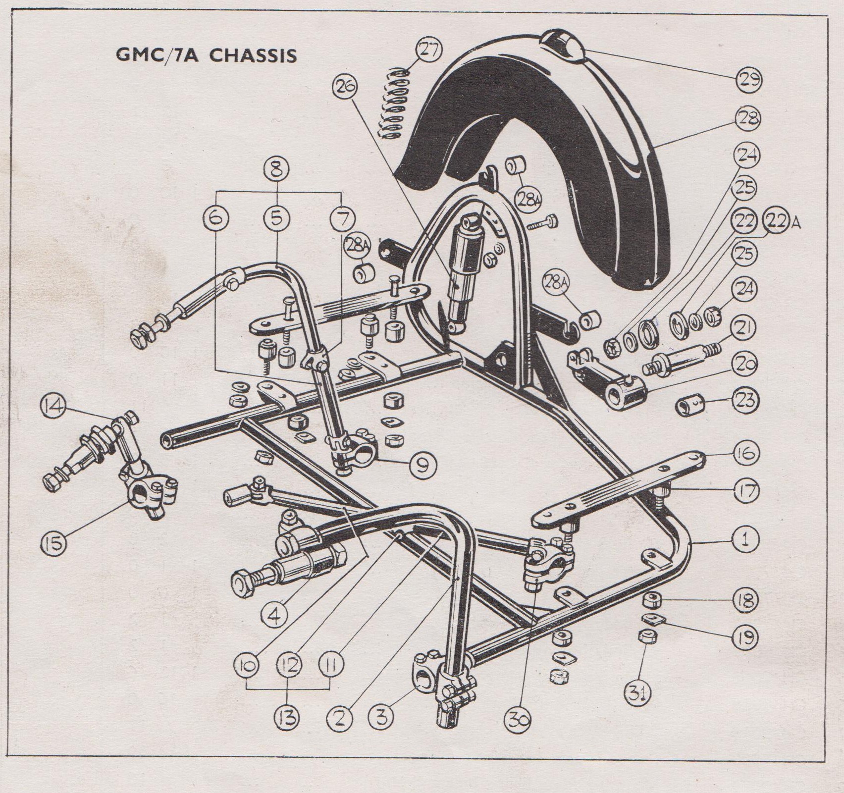

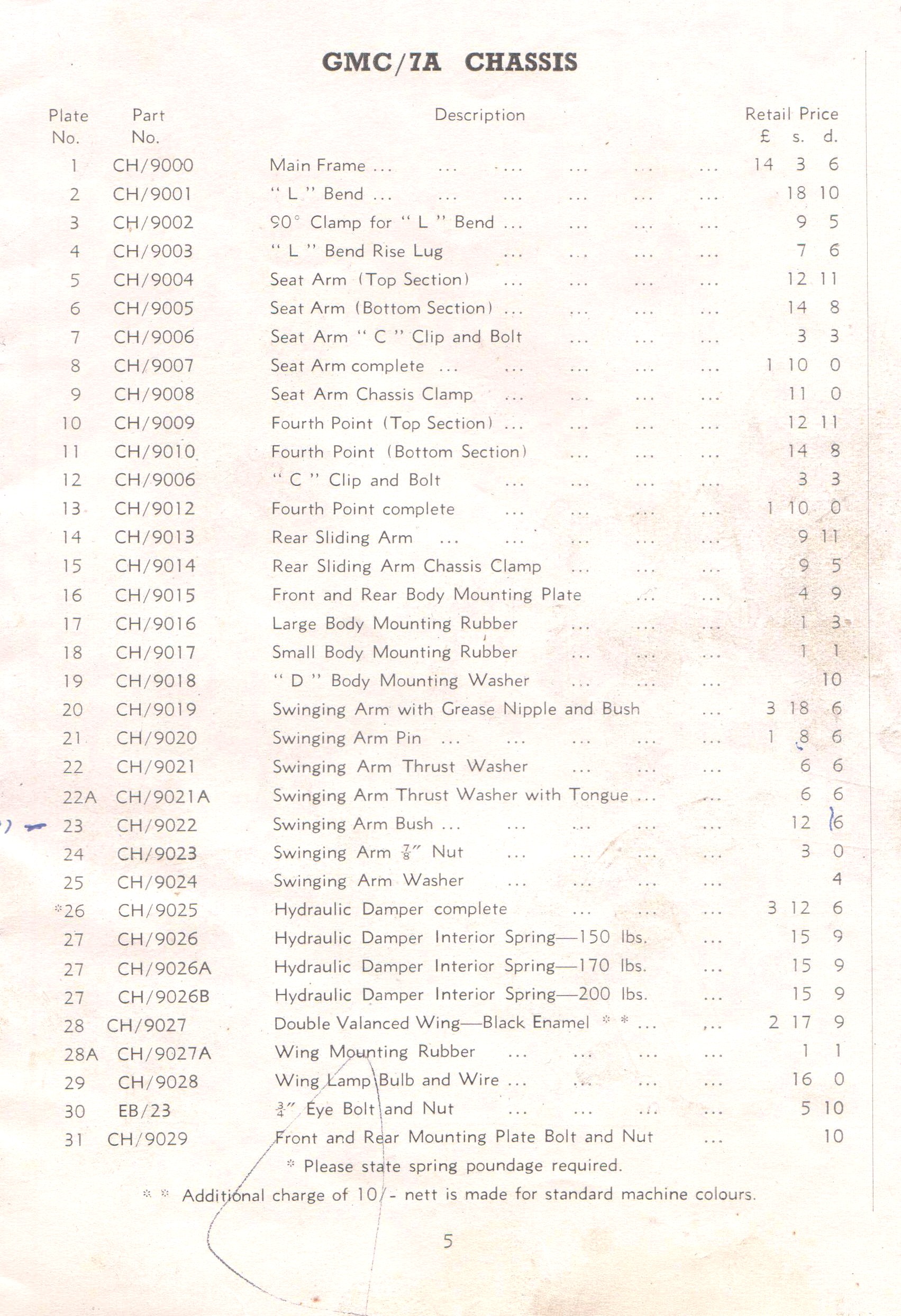

Chassis looks like a Canterbury certainly. I will scan a page from the parts list,hopefully tomorrow, and upload it. If your dog is anything like Roadsters the poor old Bantam may struggle!
