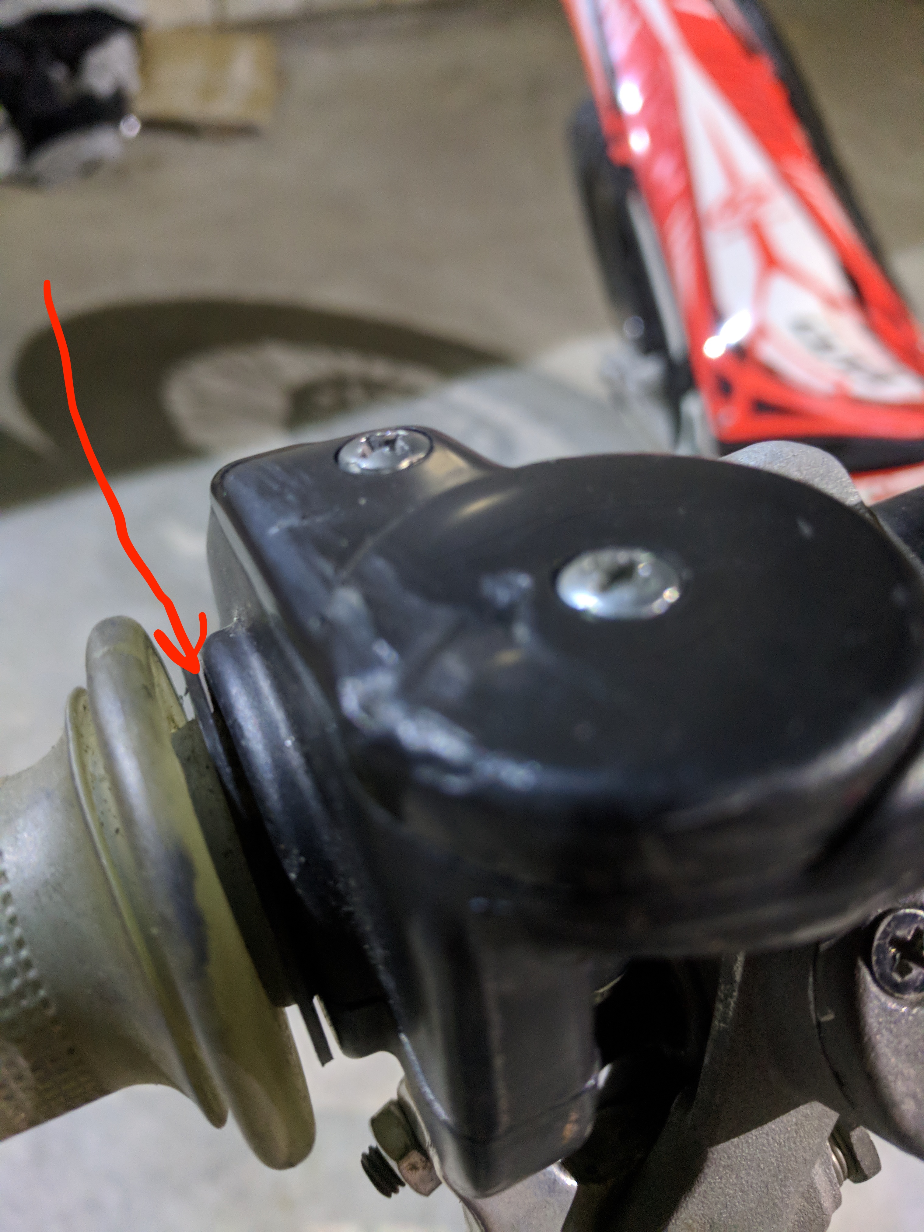

Appreciate if someone can tell me if I really have this 'slow' version of Domino throttle installed. I marked the black visible part by the red arrow.

No that's just a black plastic washer type, peel back the grip and see what colour it is under the grip.

WOW
This is a standard Beta 4T throttle tube and housing.  The Domino throttle tubes are interchangeable from slow and fast.

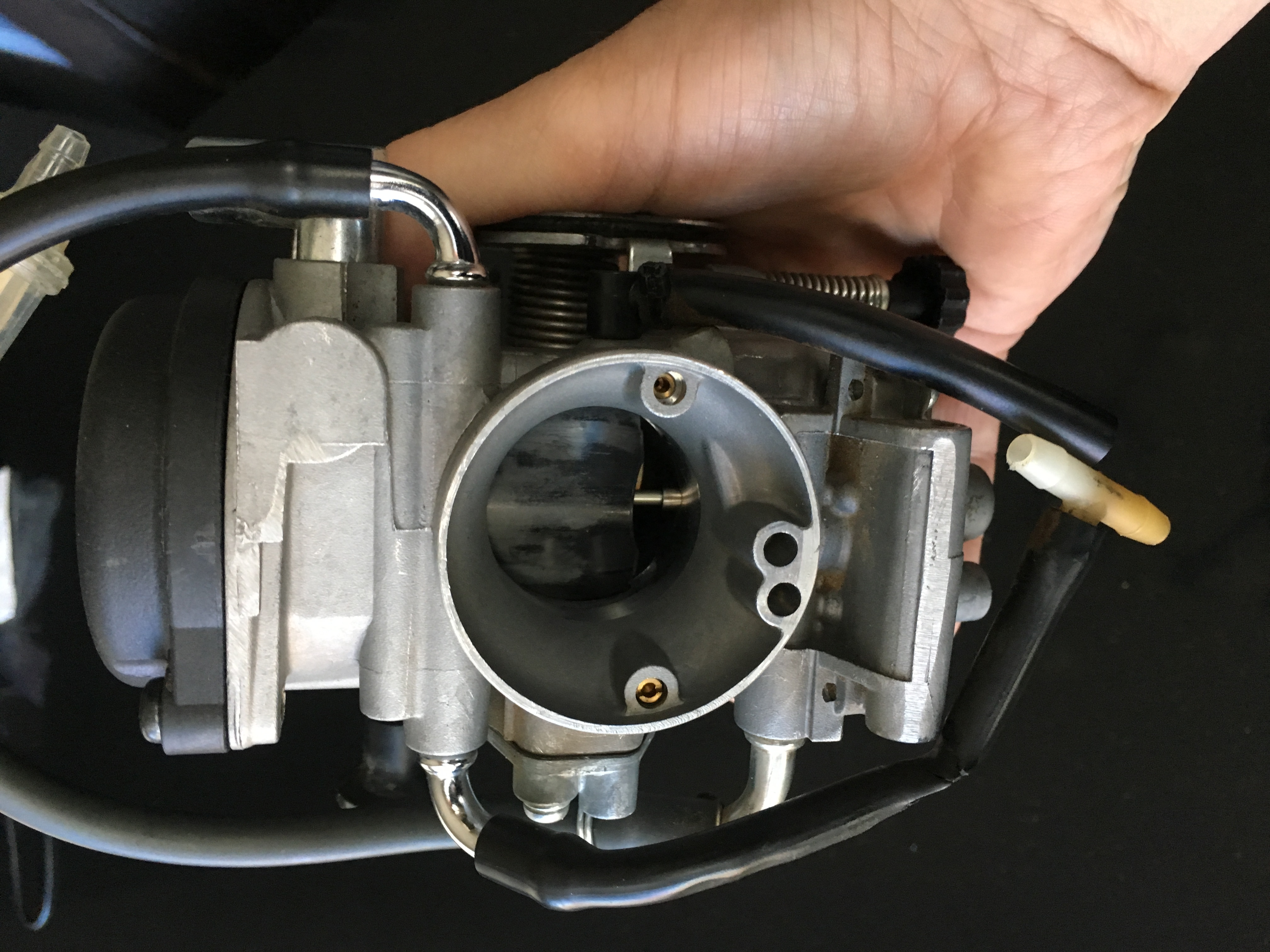

The metal housing is the stock throttle housing.  The throttle cable is not connected to the slide on this Mikuni carb as it is a CV carb.
The throttle cable is connected to a cam which in turn is connected to a butterfly valve inside the carb.

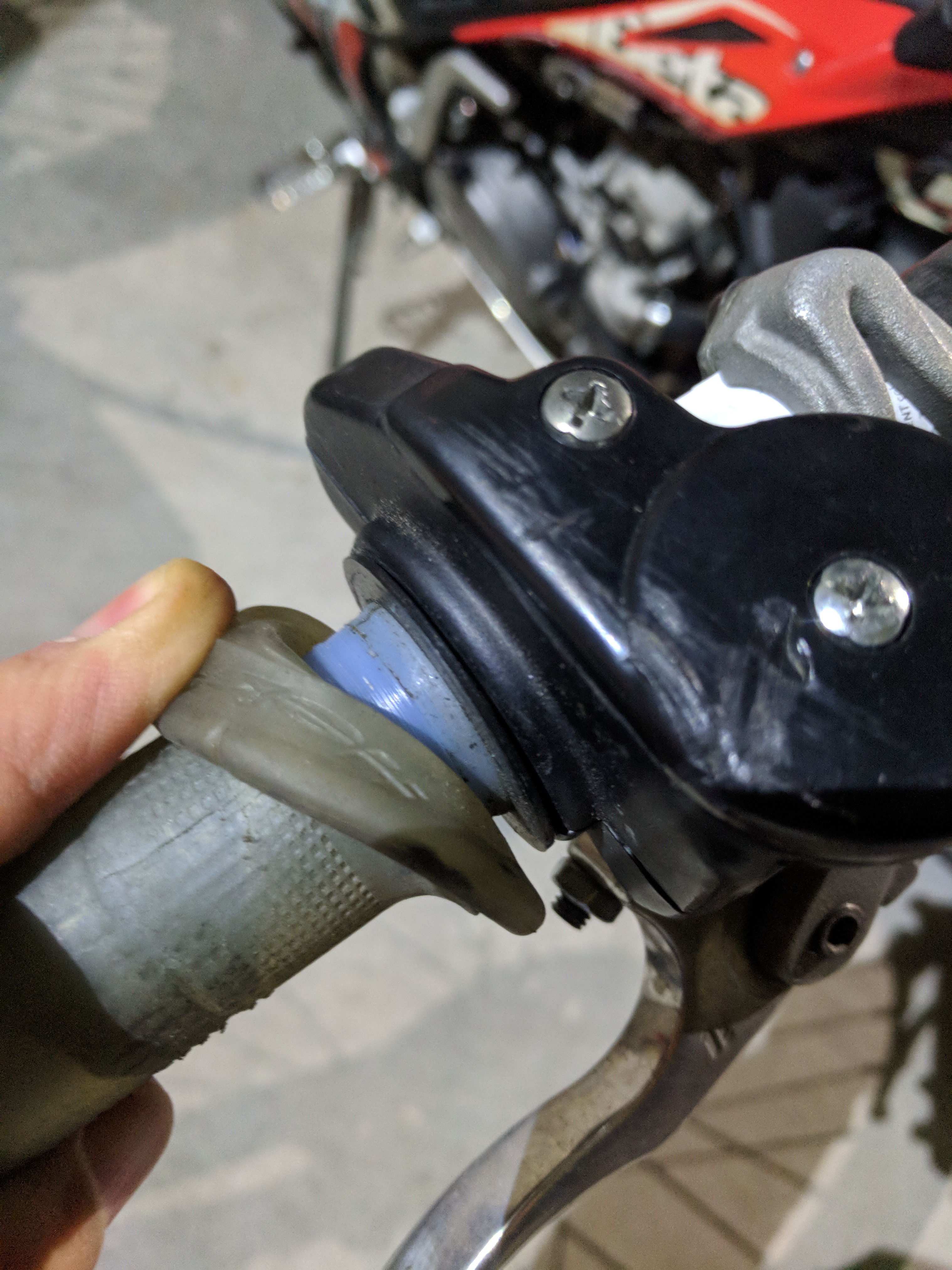

Thanks for so many suggestions. Actually, I just wanted to be sure that I use the standard or fast throttle (not the slow one). Because I don't like the idea when you have to get used to the behaviour of the slow version and then learn the throttle control again once you are ready for the fast one.
I've checked the color of the plastic throttle and it seems to be grey, so I hope it is not the slow version.IMG_20180119_191144.jpg
