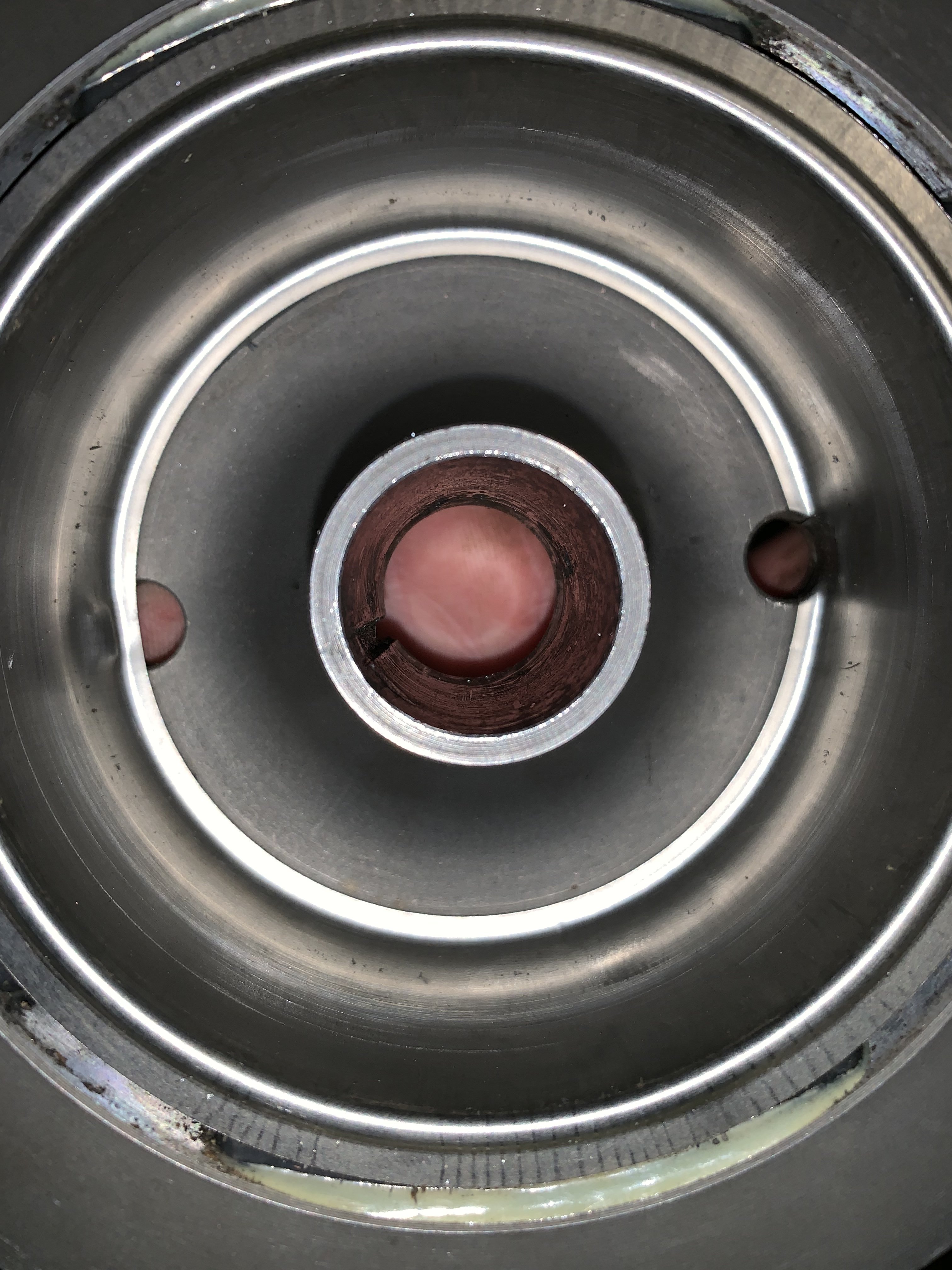

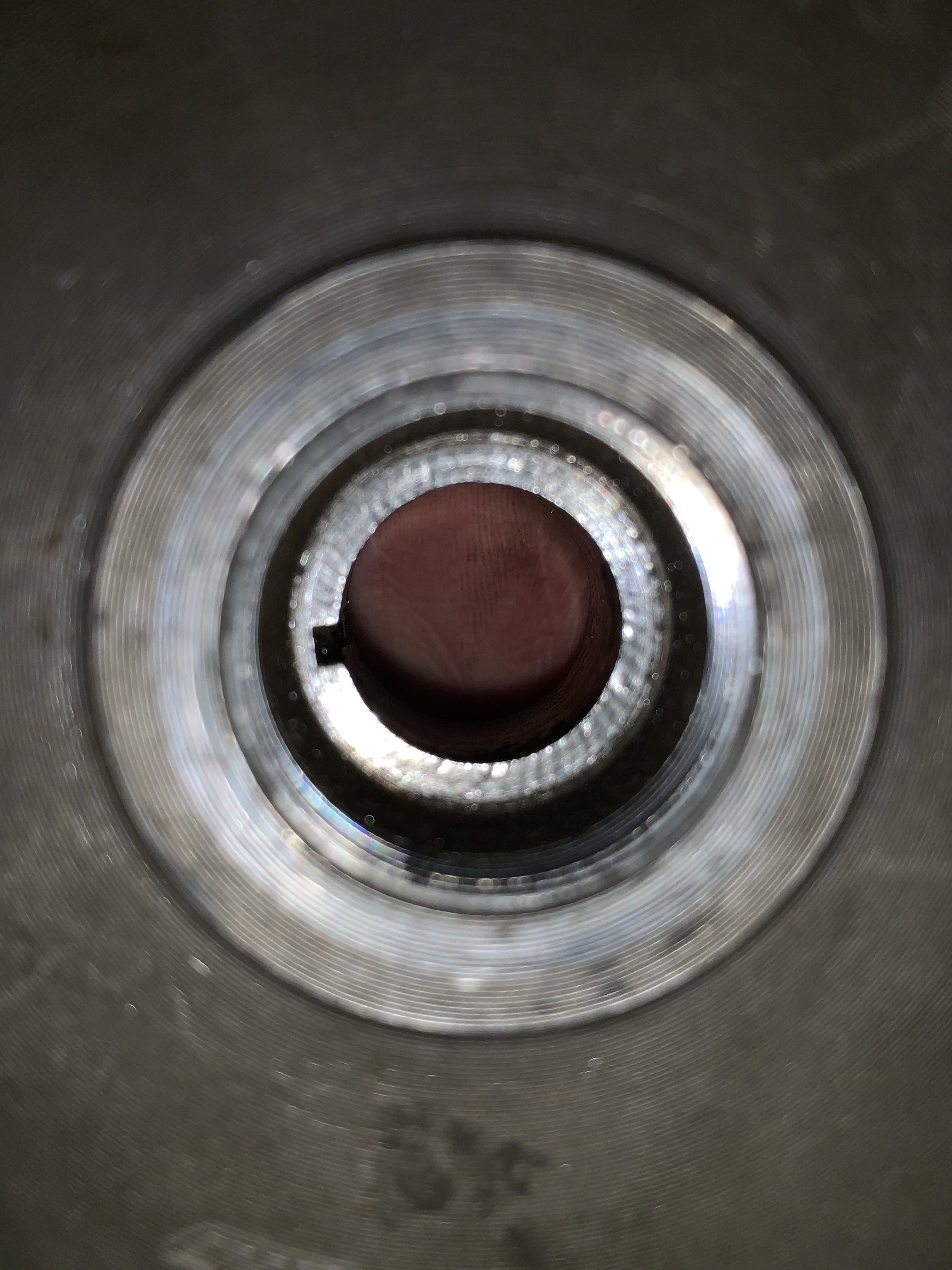

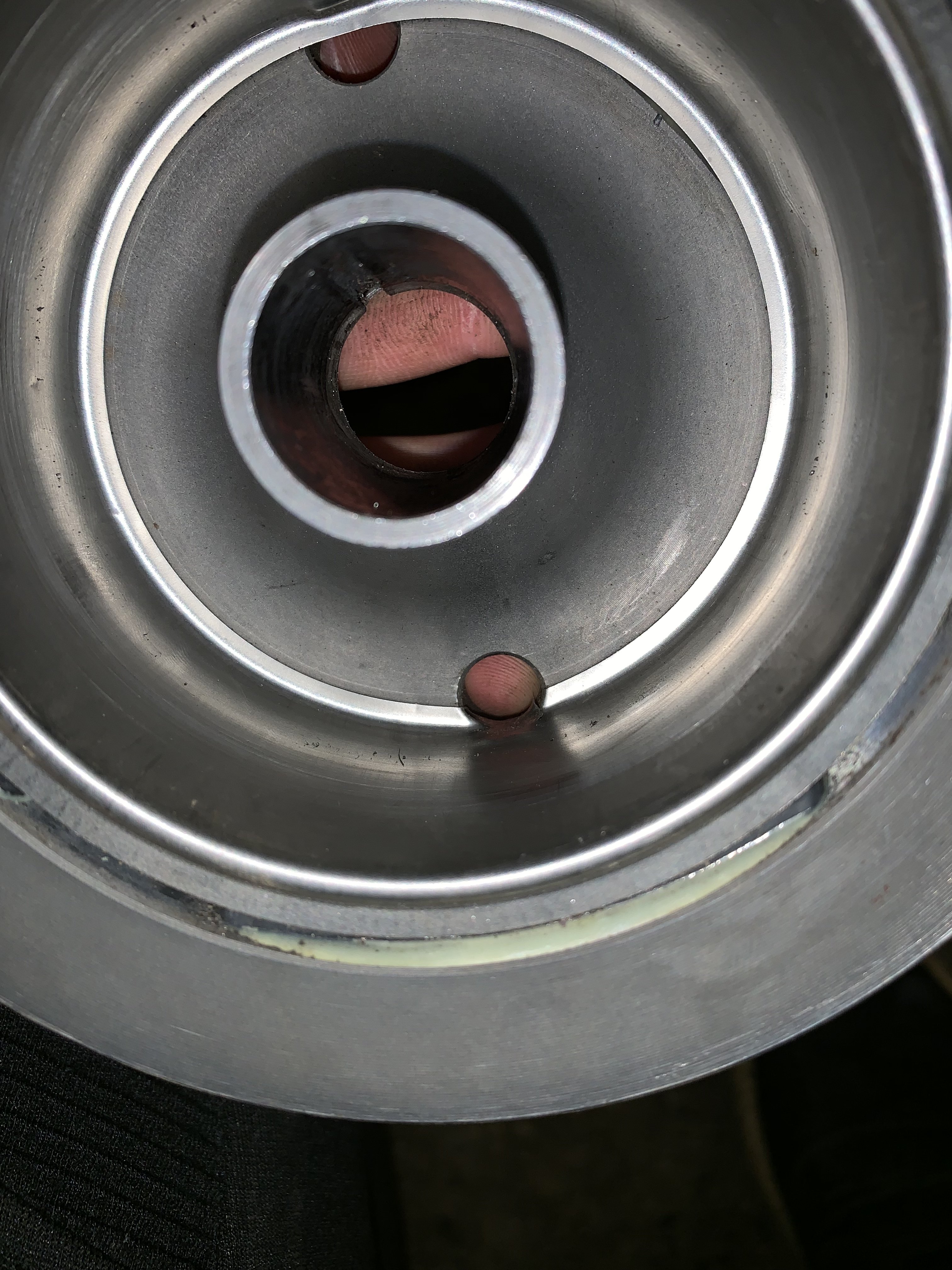

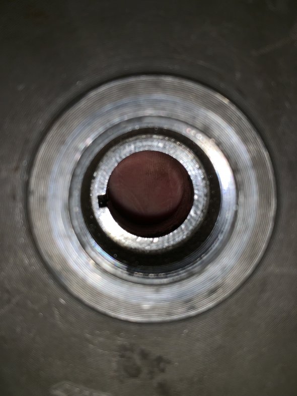

Pictures of the flywheel:
I think it looks okay but then again I have an untrained eye when it comes to this stuff, there’s a slight bit of damage on the taper and on one of the raised parts inside the flywheel

Can't see the matting surface on your photos.
With a sharpie pen, paint all conical axle surface. Put flywheel on place hold it while you spin the motor.
Paint should be removed / scrached on entirely surface showing good contact.
If not, use some abrasive paste (car popet valve grinding paste) or improvise with small sandpaper betweed both surfaces.
Turn virabrequim while hold flywheel  untill you have good contact patern.
It’s very lightly scratched on the inside of the flywheel, is this a good thing? Cheers
Share this post
Link to post
Cascoa did not mention removing the key before you try this trick, the idea is to let the two conical surfaces rub against each other and remove the ink you have put on, this shows how good the tapers are. The drive for the flywheel is through the close fitting, tightly torqued up taper. The key is there just to set the timing so your penny key should have worked.
