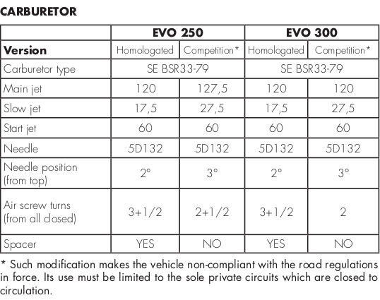

Hi all,   I'm a lucky guy that will throw a leg over a new Beta Evo 250 4T in few days. I came across this information about carb settings      I understand that homologation requirements are on the lean side and the bike should run with the competition settings.  I have a pair of questions: - What means 'spacer'? In what part of the carb is located? - Are you, beta 4T users, in agreement with the recommended settings? - Are the needed jets supplied in the crate? Well, three of them.  S
