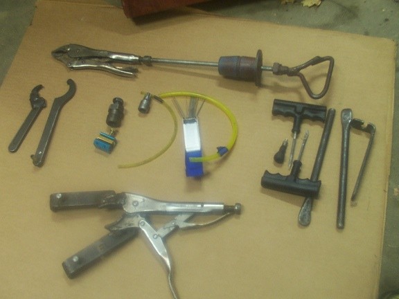

Barring that, try this slide hammer arrangement with what you call a 'mole grips', we call vise grips, on the end.
