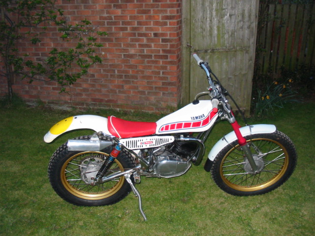

Here's a pic of my 1982 Majesty as i bought it.........it's in pretty original trim apart from new Gold rims and a SM Chrome front pipe and a WES Tailpipe.
It has the later Godden Chrome frame and main differences are geometry and ground clearance when i put it next to my TY175.
It came with Gas Girlings (now replaced with Falcon Gas Shocks and correct springs).
The engine I believe is a 175 from what I was told and not a 200,but I've not had the head off.It is a Majesty engine as the engine cases are correct,they were modified when autolube removed and a different oil pump cover is fitted,plus generator cover is cut and modified.

Left side for comparison
Nice bike. I'm building a 320 Majesty at the moment to a similar colour scheme, just hope it looks as good.
Did you by it from someone near Stoke on Trent? I'm sure I saw it at a trial near Cheadle last year, looks like the same bike.

Bought it from Derbyshire - so quite possibly could have been @ Cheadle, Woody
