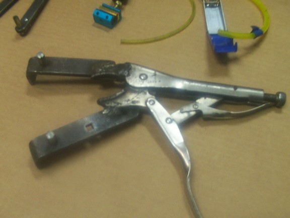

I've been running the Motul two stroke gear oil for about two years. I did adjust the clutch about two weeks ago when I replaced the clutch cable. I guess I will go on and pull the clutch out so I can adjust the shifter and check the clutch plates while I am at it. It might be that it is in need of replacement. Should I get a clutch holder tool to remove the clutch basket or is it really necessary? Sounds like a good question for Charlie Chitlins. This "over the winter" rebuild is sure dragging on but this is the last thing left.
the tool is really handy, and saves risking gear teeth or basket parts.
pic of a homemade one is attached.

Thanks for the picture Kevin. Made me a pair last week and worked perfect.
