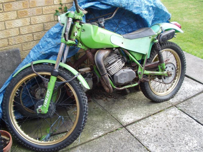

Just bought this Italjet 80 for my Son, it in a bit of a state but with new mudguards and lick of paint it should be OK.
Its about half way between a Ty80 and a full size bike.
The engine rumbled some what so I stripped it down, when I took off the exhaust there was about half a pint of oil in it! further inspection found the main bearings and seals are gone.
Ive been told Harglo-Performance have spares for them so I will try them on Monday.
Anyone know any other sources for spares for these or any info at all I they any good, can't seem to find much on the net other than one or two pictures.

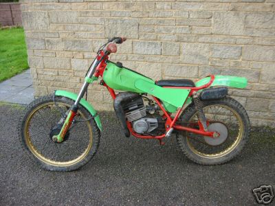

I found this picture of one as well
I sold this one last year on Ebay. It was a total wreck and still fetched about
