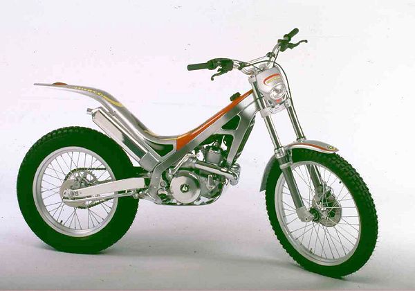

but if i were you i wouldnt bother with the sherco plastic for a number of reasons. people will take the p*** out of you for having a sherco/beta hybrid bike and it will never look as good as the original 95 beta mudguard. i think it would also be usefull to add that the sherco rear mudguard is alot more brittle than the techno's. Heres a pic of the 99 sherco
any hill if you do do this bodge yor engine is mostly gonna get buggered because the sherco mudguard will not seal round were all the airbox is and you end up with dirt going through ya filter and into your engine and that aint good
