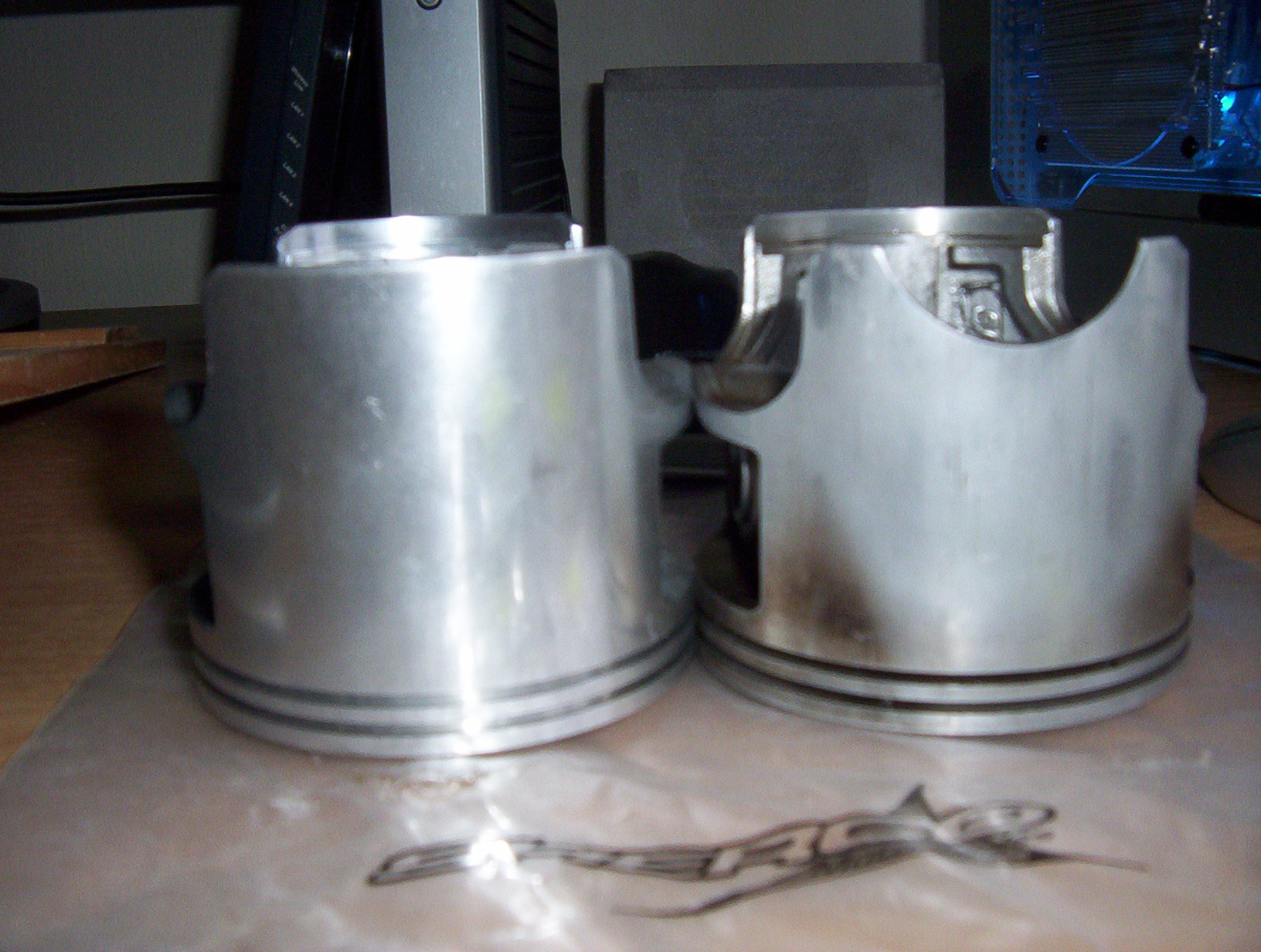

I bought the bike second hand so never knew that the compression was low, its always just been like that. Takes a good oul kick now to start it, and the extra power is noticable. Decided that I would replace the Pistion and top end bearing while I had it all apart. Problem 2 - My original piston has a semi circular cut out in the skirt at the rear, I bought a new piston from the dealer and it doesn't have the same cut out. When I returned it as I presumed it was the wrong one I was told its ok thats just the way they come now. This seems strange the cut out leaves the inlet port open where as the new pison almost completly covers same port. The bike just couldn't run properly. It would be the same as putting the piston in back to front. Has anybody replaced a piston lately? Is this the correct piston? The dealer has no other and is certain its the correct piston, im considering altering the new piston to match the old one, or reusing the old piston, but that would be a waste of E90.

Thoughts, well I'm not quite sure what you have done to fix it! Would require a signifigant loss of compression for it to not run, however if you noticed a major difference in kickover?
I seem to recall the later model pistons not having the cutaway, as the later bikes are tuned a bit smoother, I think RLracer just installed one in a bike, maybe he can confirm. But if it runs fine I would not be overly concerned about it.

You may well have been supplied with the correct piston but it might need the skirt milling?? or filing?? if it won't run properly un-modified.

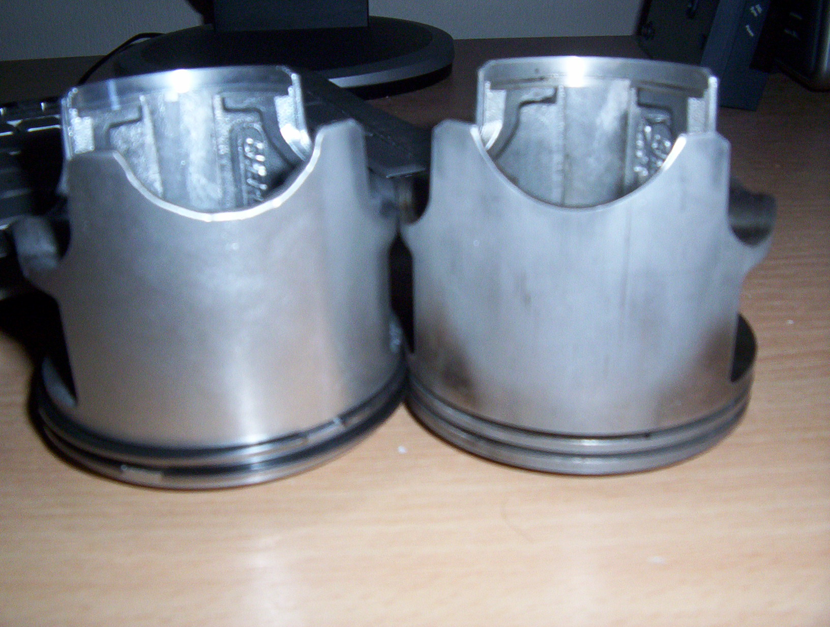

In the end I gave in and modified the piston couple of mins with a file, it turned out quite well.

They say a picture tells a thousand words, so here you are.
Conor
Conor, in Spain they call that a "new engine thermodynamic" or something like that i believe! It should probably work untill the 2012 models arrive! :banana2:
