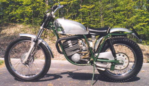

attachment=6157:path7.jpg]
I don,t think that is a Pathfinder frame you have, The Pathfinder looks like this.
I'm afraid to ask how much all that iron added to the weight of the bike.
I've seen people who have taken aluminum snow shovels and made bash plates, but never chunks of steel.
I think, 'I KNOW WHAT I WOULD DO WITH THAT SHOVEL....................' sorry.............
Could be an early Greeves Anglian with 'Banana' Forks.
What's the frame code? TGS?
What happened to the Villiers engine? The Greeves alloy Challenger barrel and head from an Anglian is much sought after.
