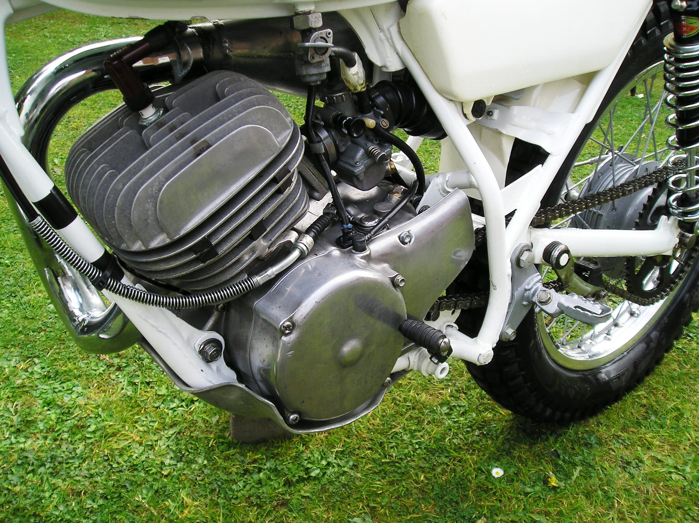

hours of polishing, but i wish i had'nt. the fins need constant attention to stop them furring up, some day i will get round to taking the top end off and painting black.
p.s. i know the case screws are a right mess, i could'nt wait to take the photos so i stuck the old ones in.
If it's any consolation, we did some heat dissipation testing years ago (before liquid cooling was the norm) on raw aluminum MX engine parts vs. flat black and found that the flat black finish on aluminum parts reduced temperatures by up to 15%. A satin black finish (which would look better) would probably yield a little less effeciency but still was better than the natural finish. A rough, as-cast surface was better at heat reduction, rather than a smooth, polished surface, probably due to the greater surface area.
