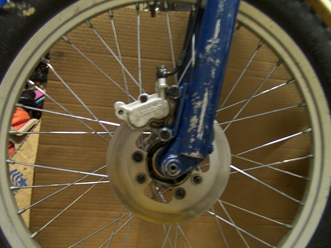

I have tried all the normal fixes, shoes, grooves, sanding shoes and drums, etc. etc. Have never tried the change from single leading shoe to doulbe leading shoe.
Then I looked into fitting forks etc from an older eta or Fantic. Rake & trail issues there.

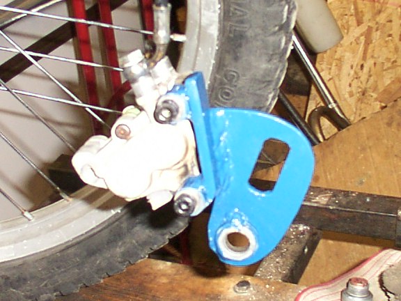

Finally I fell into a very easy conversion: I fittted a 2000+- GasGas front wheel and 4 piston caliper to the Yam. I made a bracket that pilots on the axle, takes the torque reaction via the original lug on the Yam fork. It works great, doesn't require welding, and the original drum front wheel and drum can be put back on if desired.
downside: bracket is steel, all I can weld. It is heavy. Alsi, the wheel is not quite centered, maybe 1 to 2 mmm offset to one side. I can't teel any difference.
I made axle spaces to fit the ID/OD and distance differences. (Actually, so far they are washers and hand made bushings. I have the dimensions, just don't have the machine work source yet.
I changed tohe caliper bolts to button head allen screws to get a couple mm more clearance, trimmed the lug on the Yam fork a bit, and the wheel is closely centered.
I love it. Works great, all the parts are modern instead of old Fantic or something, and I can always rob it back to supply the GG with a wheel.

pic 1.
pic 2

nice work!
My kinda guy!
