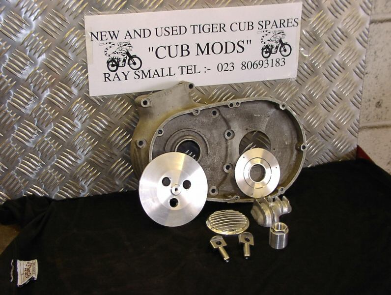

I think they need a longer swinging arm to grip better and give more clearance for a 4.00 x 18 rear tyre. There's a few people that do a conversion - Ray Small at Cub Mods can help you.
The best ignition is to use PVL, requires the cases to be machines to suit - its also the most expensive. There are cheaper alternatives that will get you a reliable spark though - ditto above

Hi Subira
Do have a web Address or phone No for Cub Mods,
triton.
I lifted this from eBay a while back. Hope it doesn't upset anyone
